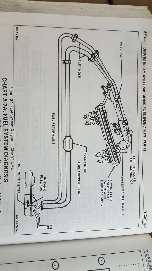

Looking at this picture from the FSM, it would mean I have a leaking injector. Even if the FPR was shot, since the return line is blocked, the fuel has nowhere to go.
I've checked all injectors and they all read between 16.6 and 16.9 ohm. The cold start injector is at 4.4 ohm.

Originally Posted by denraf

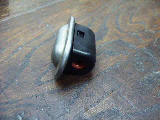

Not sure what you mean with the dampner.
sits between the pump and the metal rail
We need to see if the FPR is sending fuel back via the hose to the intake. Pull hose and see if it smells of fuel. You can get a kit with all the stuff including the right hose to replace your dampner HERE.
If I were you, I'd forget that test altogether. All it tells you is the coil is good. I had an injector off my MB that was good according to the DVOM. You blow through the inlet and air comes out the other end. There is only one test, IMO, that is worth a damn and that is on the flow bench. I test my injectors every 3 years because that seem to be enough crud build up that causes concern. No, snake oils to clean injectors I don't intend to waste money on. The ohm reading gives you a false sense of security that the injectors are good. I can saw off the bottom half and it will still ohm good. If you have Multec injectors, don't bother. Give FIC a call and he will be able to send you a rebuilt set. Also change your FPR since you are there.

When switching the ignition of, it drops steadily to about 30psi.
Unfortunately this still does not solve the problem. The backfiring is still there. As the fuel pressure still dropped, I checked the cold start injector as that was not replaced. It is bone dry, however so also that is not the problem.
Weird. That is high. Without vacuum it shouldn't be more than 44, Regulator, maybe?
