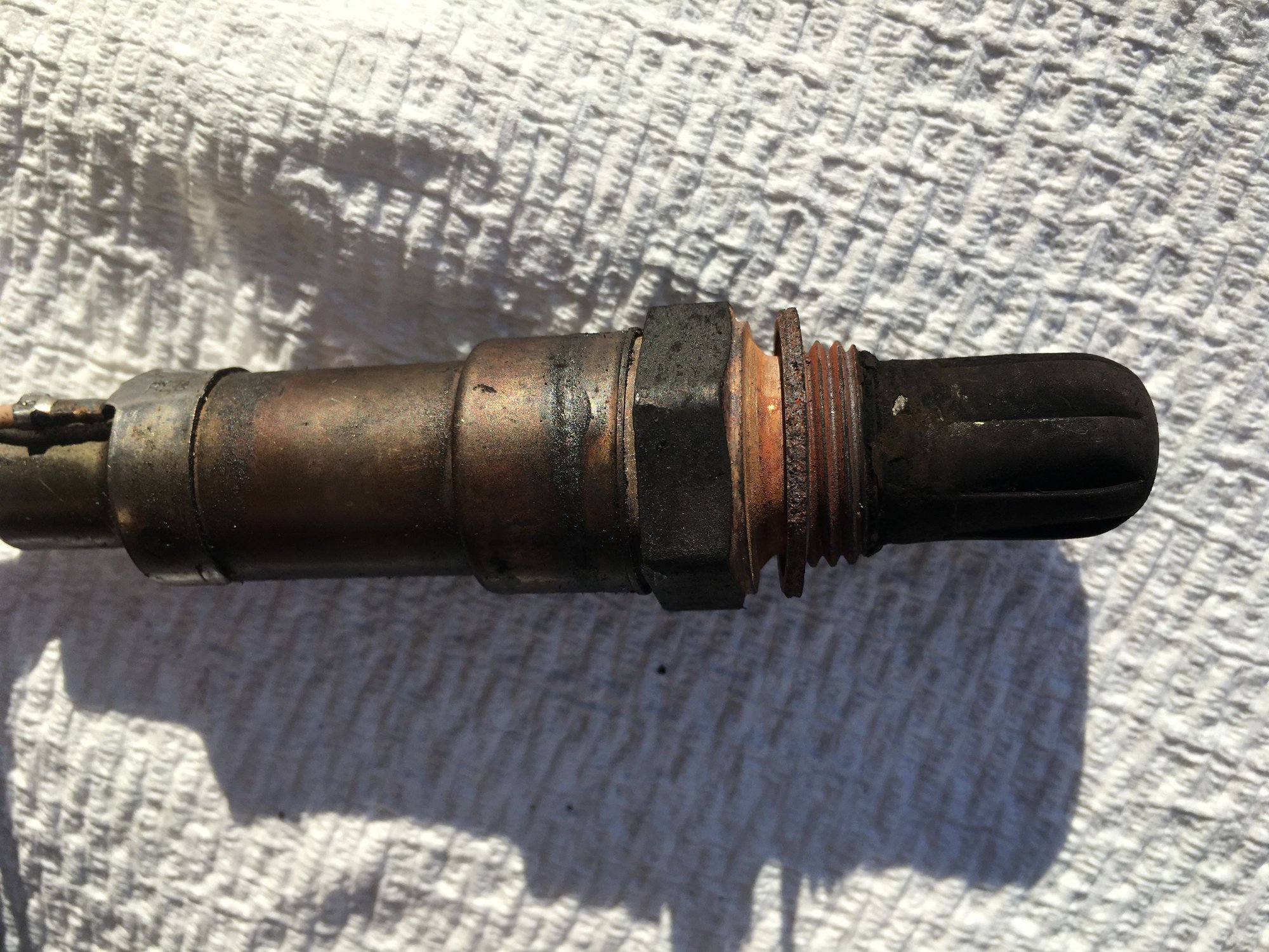

Changed right o2 sensor and no more codes! This one looks like original with 100k miles!
I went to AutoBone for two sensors since the ones from Rock Auto were only two wired. Autozone only had one so I changed right side and it works. The driver side is the newer one so hopefully it will work until I get a new one. The VSS was ordered but did not come in so I will just return it.
