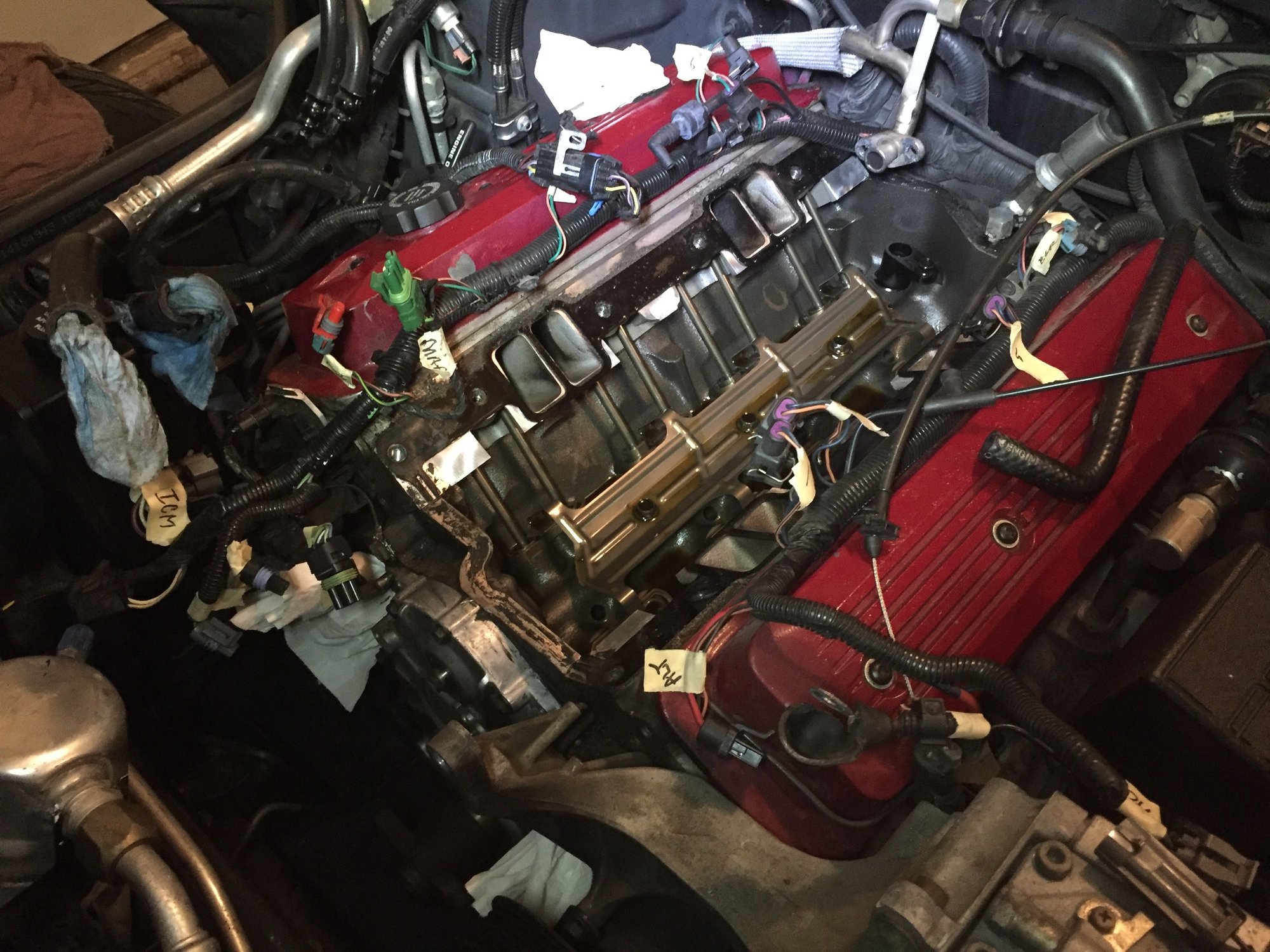

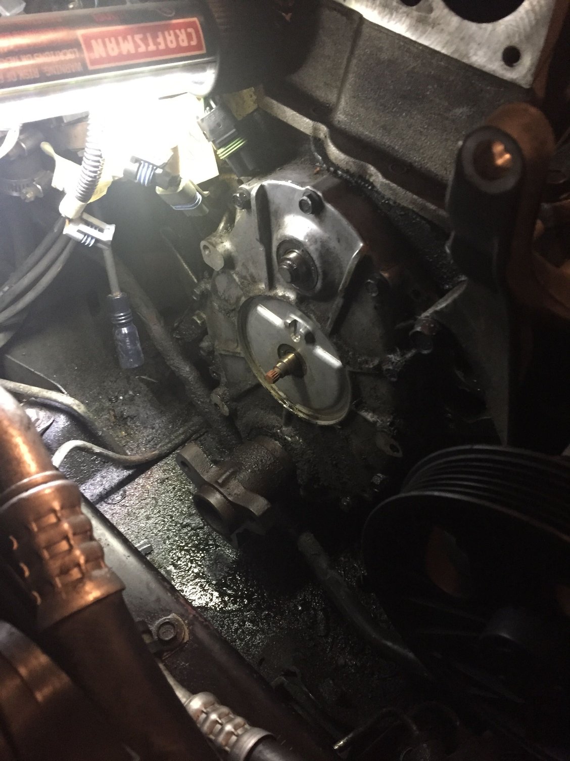

Well I did get this far tonight.
The seals should really be replaced... if I can rig some kind puller I might be alright. Still a little tempted to pull motor just to clean everything up and re gasket the whole thing. Always wanted to try it. One thing at a time though. I'm not going with the electric pump. I found a replacement drive and I already have a new pump, thermostat, temp sensor, and gaskets so I'll keep trucking will keep updated

Looks like you have ti under control and have the skill to complete,GOOD LUCK,will stay tuned in for outcome.

Intake must come off too as nentioned.
To get that damned hub off there GM made a special puller, but you can use an old school if you carefully grind three notches in the OD of the hub.

Pulled intake, going to try to borrow hub puller this weekend to pull timing cover. Will inspect chain while replacing pump drive. Also going to remove valve covers and get that red paint off and replace gaskets of course. Only have a few hours every couple nights but it's getting there. Should have it going in time for another Ohio winter. Having fun though.
Thanks for the interest and input. I've never done any of this before so all the advice I get is certainly useful. Cheers

Glad you're having fun with it. Getting to everything is much easier is you put the front on jackstands and remove the wheels; just don't stab your ceiling with your hood if you go that route. Others may have differing opinions on this, but I would pull the rockers too to avoid the valvespring pressure from causing any changes in the cam position when you remove the gear and chain. Adjusting the valve lash is something everyone should do at least once in their life in my opinion anyhow!

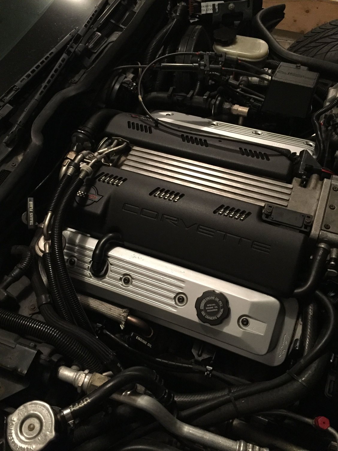

Back together and runs. Quick drive last night, the car seemed fine as far as stumbling and hesitation. I'll have to drive more to know for sure but no mor coolant or oil leaks so far. Here are some pics
New PETRIS opti
New pump drive, don't break these...

Looks good!

Good job wish you would have cleaned it. Did you locktight the cap and rotor and seal the waterpump bolts?
Yes on thread sealer for water pump bolts. As for the opti I left it as it came to me from PETRIS. I'm relying on their good reputation I suppose..

Very Impressive! Great job and write up/pics.

Congratulations on doing a great job! Glad to see you're back in action. Nice job cleaning up the engine also.
