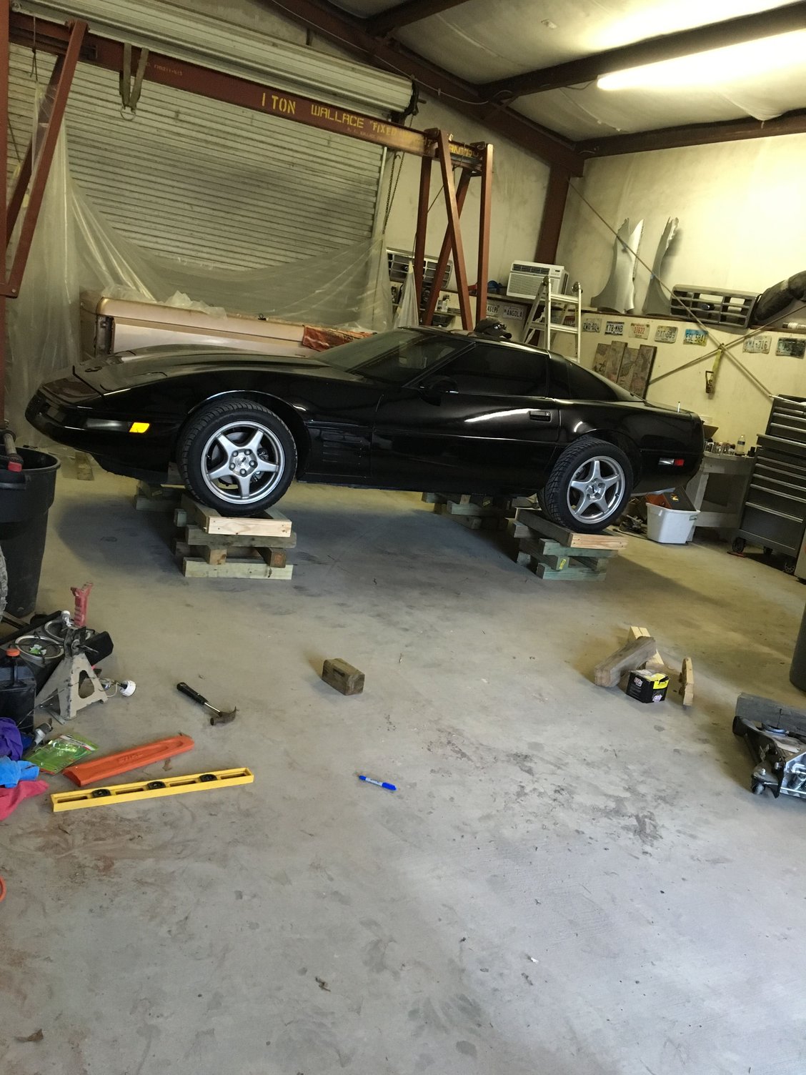

So I got it up on these blocks and got most of the exhaust undone before I called it a day. I'm sure it's comical to anybody else to see the car on blocks like this and believe me it is for me too but it works! Tomorrow I'm gonna work on getting the driveshaft out to check the u joints just to be sure and if those aren't it I guess my next step is removing the trans to check the clutch. This is the first corvette I've owned so I'm kinda learning as I go. By no means a professional

I use oak stumps. I would have wiggled the wheel and checked the flywheel bolts first.

What's amazing to me is that in that pic? lower left of pic, there is a device already right there...that is engineered, designed and built to do what that contraption you built will do...+, let your work on wheel/brake/suspension to boot! The Jack Stand.
Good luck w/the trans drop.

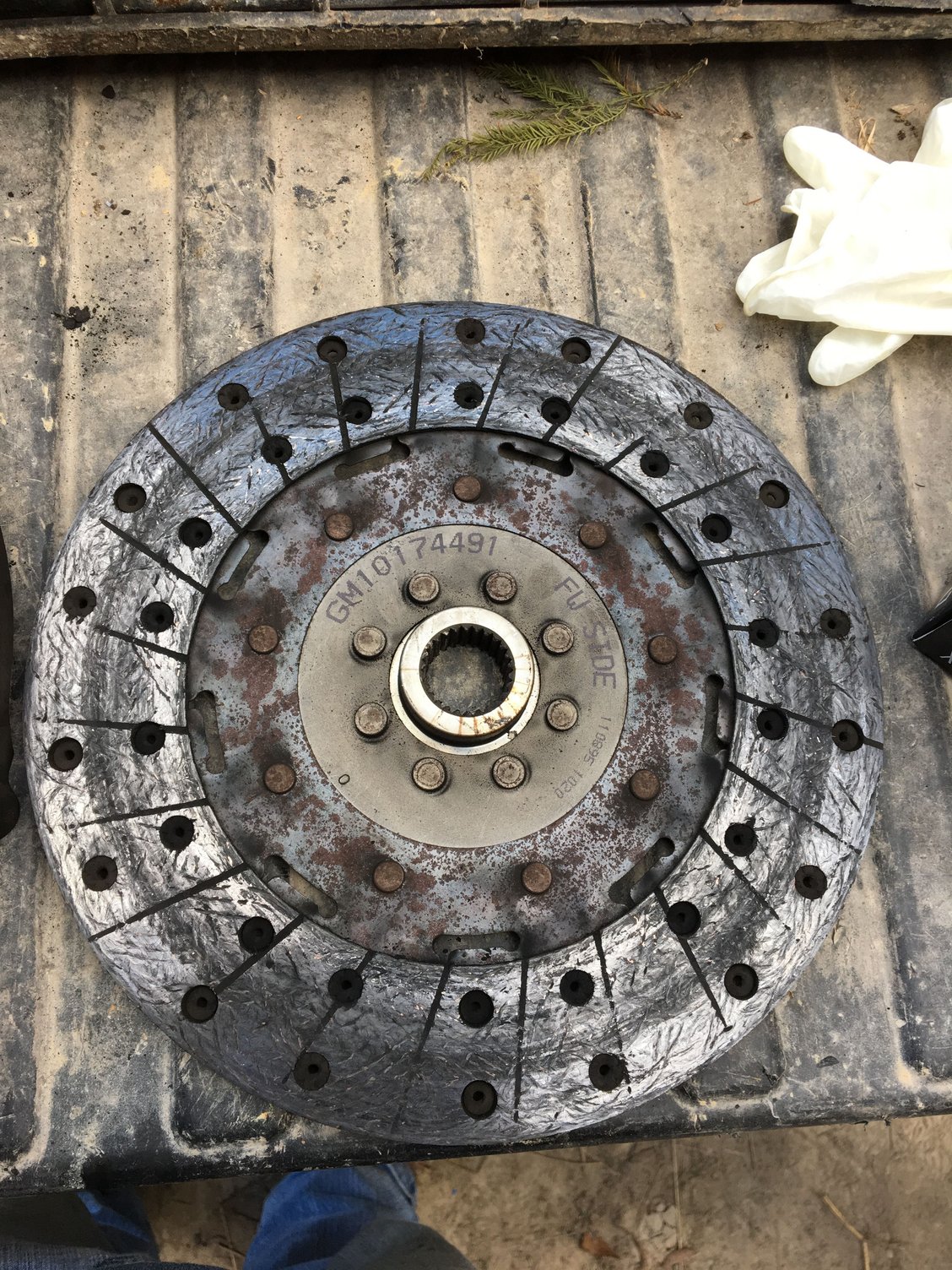

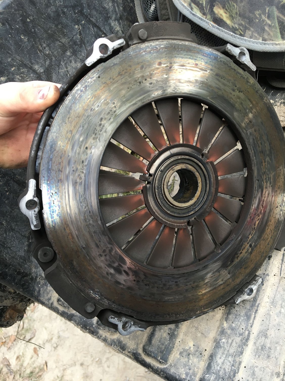

okay so the other day I got the clutch out and it's pretty bad. The pressure plate is all kinds of different colors from burn marks lol I'm sure all the burnouts and me driving the hell out if it didn't help but live and learn! Now I'm trying to decide on which clutch I should get. Eventually might put a cam in it but no time soon. I'm looking at spec clutches but I don't know if they come with the throw out bearing and that alone is 96 bucks from center force. McLeod has a kit for 550 that comes with one but it's says its for a 5.0 Chevy however the clutch disk is the same size as mine. Any suggestions? It also already has a solid flywheel so I'm just gonna get that resurfaced

You can see the burn marks and it's pitted pretty bad in some spots

The pitting is interesting. The burn marks are probably not a big deal, given that they are evenly distributed around the whole surface. It doesn't look like you were down to the rivets on the disk yet. I don't see anything here that would lead to the noises you described, but I hope this does solve the issue for you.
In the meantime, don't throw away that pressure plate! It might be possible to machine it, and you or someone else could use it again. In fact, if I were you I'd do that and keep it on a shelf somewhere in case the SPEC p/p doesn't work out so well. If you get it machined, you need to also machine the legs the same amount to preserve the distance between the legs and the friction surface. Jim at powertorquesystems.com can tell you all about it, but the measure you want to preserve is between 0.195-0.205". The thing that might prevent you from successfully machining it is the pitting, but it's hard to tell from the pics how deep or big they really are.
