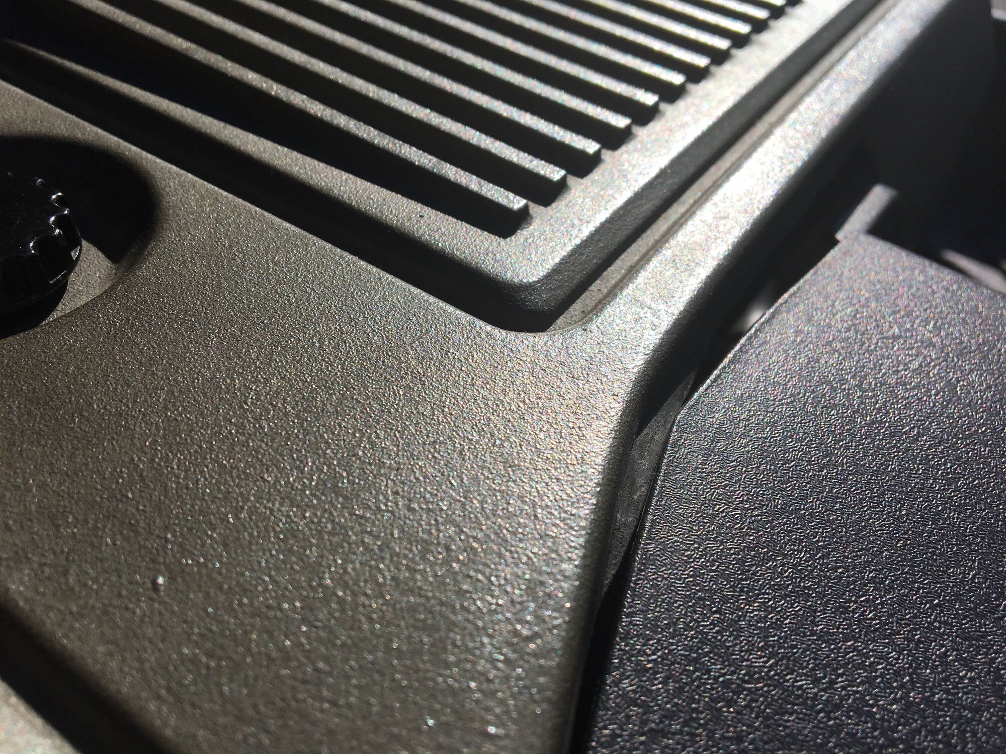

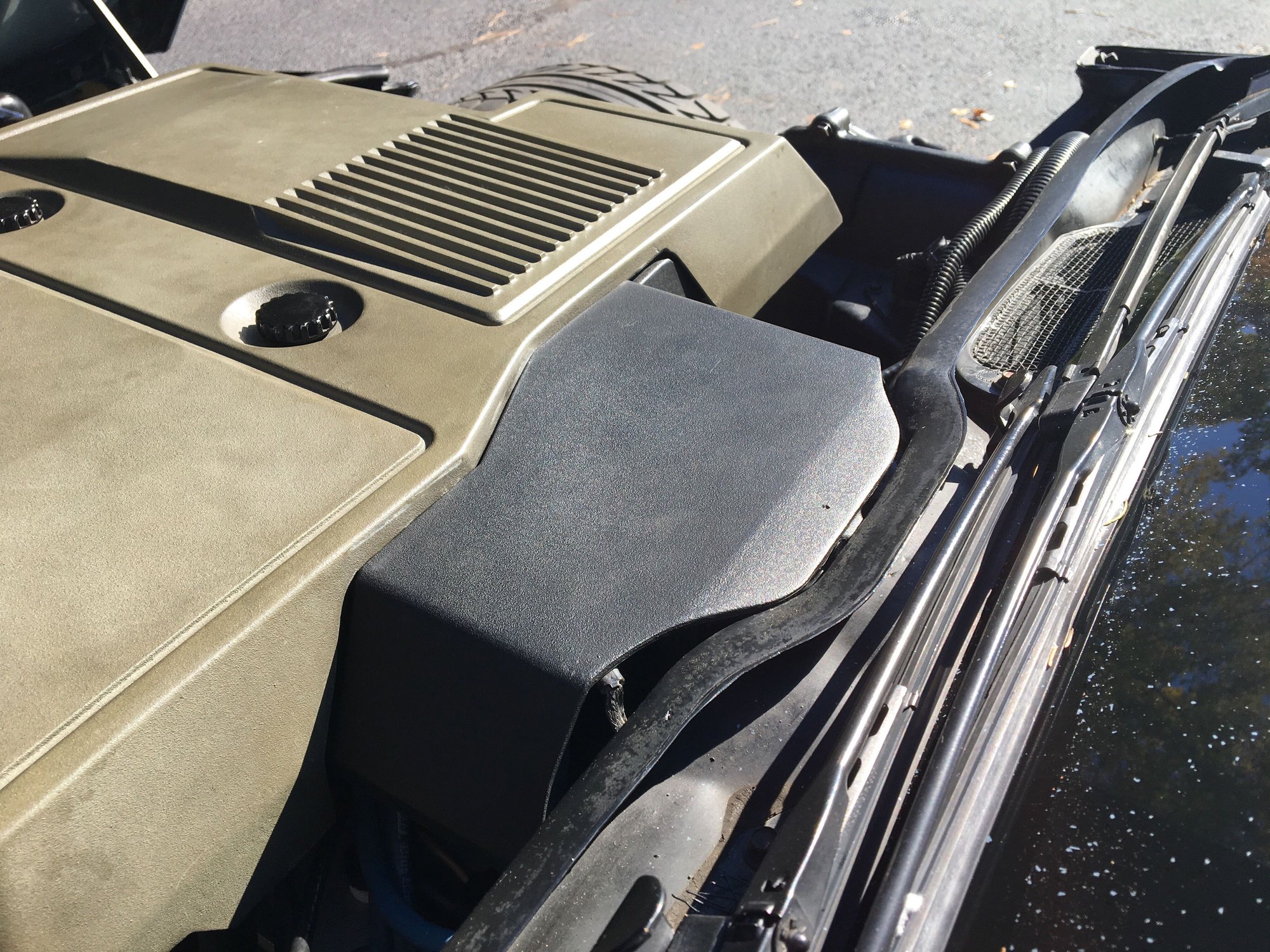

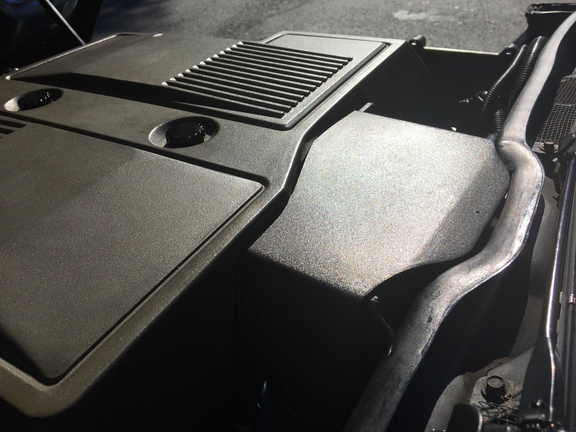

Aright so I took a crack at it today.
heres some pics from before
Before
I made some measurements of the K & N... looks like one side of it was a whole 0.100 taller than the other and both sides were over spec so... I took threw it in my vice and smashed the whole thing down till it could easily be compressed by hand, then put it in and cranked down the bolts all the way to the stops, then let them up and put them at a torque where they could be removed easily. It sits right or close to right now.
After
The air flap gaskets now make contact with the magnesium cover too.
