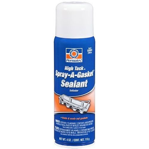

according to my 90 FSM, the torque spec for the VC bolts is 90 INCH lbs. I would think your 89 is the same. gasket installation tip - while the gaskets do not need any type of sealant, to aid in installation, use some gasket tack to hold the gasket to the VC for lowering onto the cylinder head. the perimeter bolts are different from the center bolt types in that the perimeter types are held in place by the VC/cylinder head studs. here's the stickem I used during assembly of my 90 -
