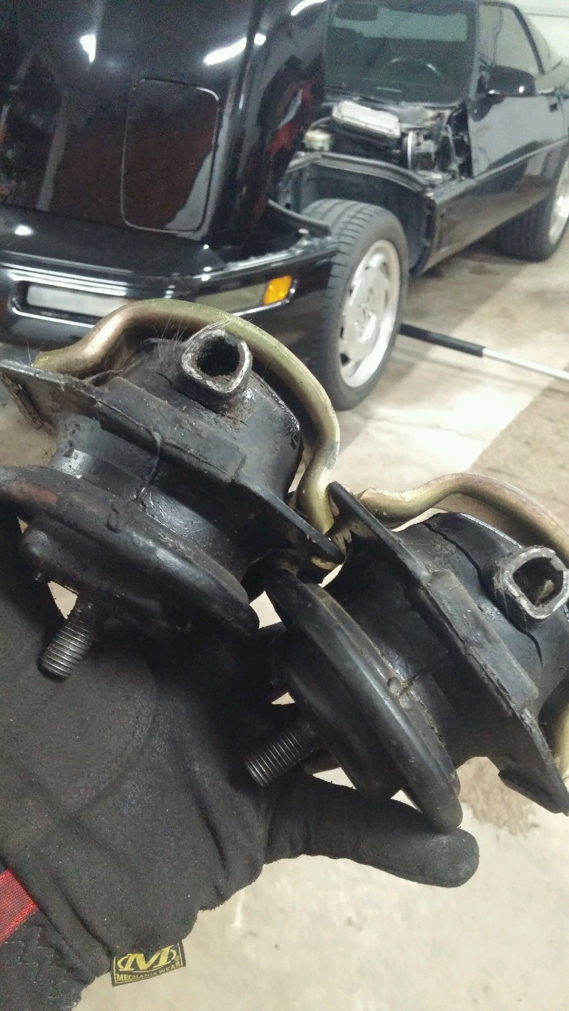

My LT4 car only had 79K miles on it, and this is what they looked like. It's not a tough job, but does require some patience.
Yep, thats what I am expecting to see.
