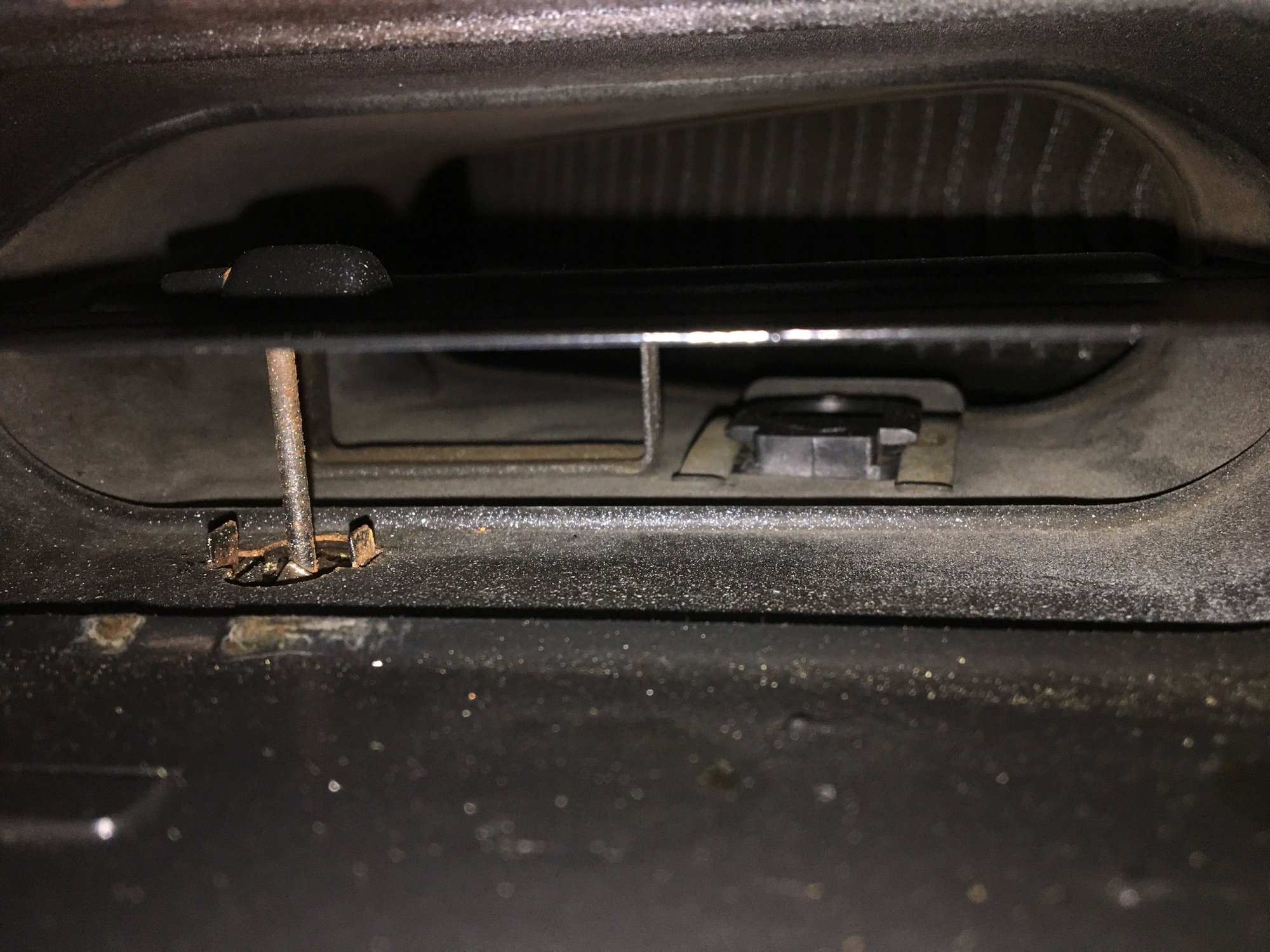

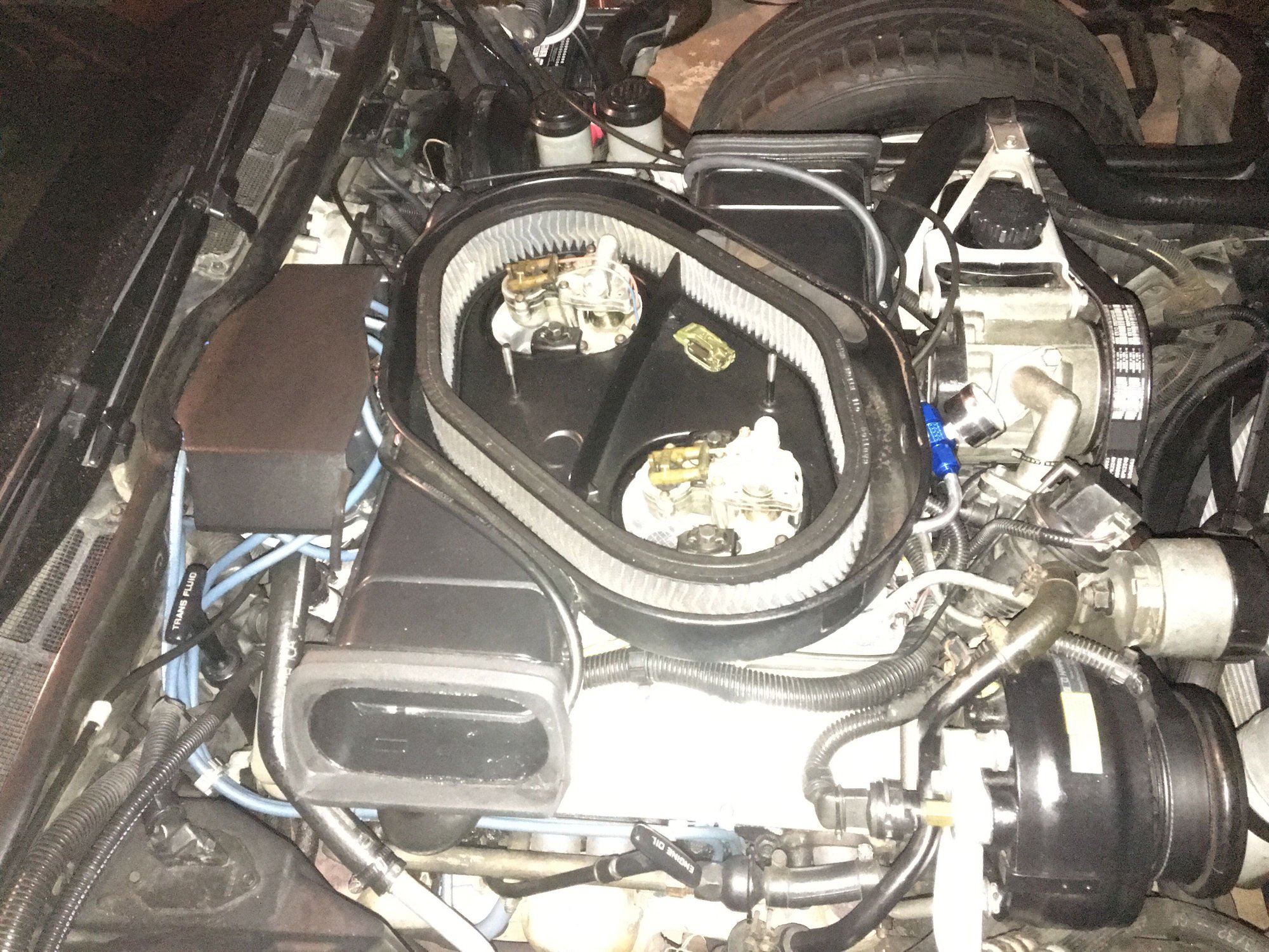

That doesnt appear to be the case in my 84, unless theres a filter in that rubber hose... heres some pics I just took to show you what I mean (sorry about the quality)
As you can see, the hose attaches to the air filter housing outside the air filter. Air could potentially come through the hood > down the hose > passenger valve cover > lifter valley > driver valve cover > up PCV system > into intake plenum without ever going through a filter element. Not that I think its a super big issue or anything...
Perhaps I'm missing something though?
Nope. You aren't missing anything. That's crazy. I've never seen one plumbed that way before. I agree that it's not a huge issue...but why didn't GM move that grommet over a few inches so it was w/in the filtered air!? Kooky.
Yep, a filter would be better than what GM did there. The PCV system draws UP TO 9 CFM so over the life of the car, that is a meaningful amount of unfiltered air drawn into the crank case area. Weird...and good observation. Thanks for posting the pics!
