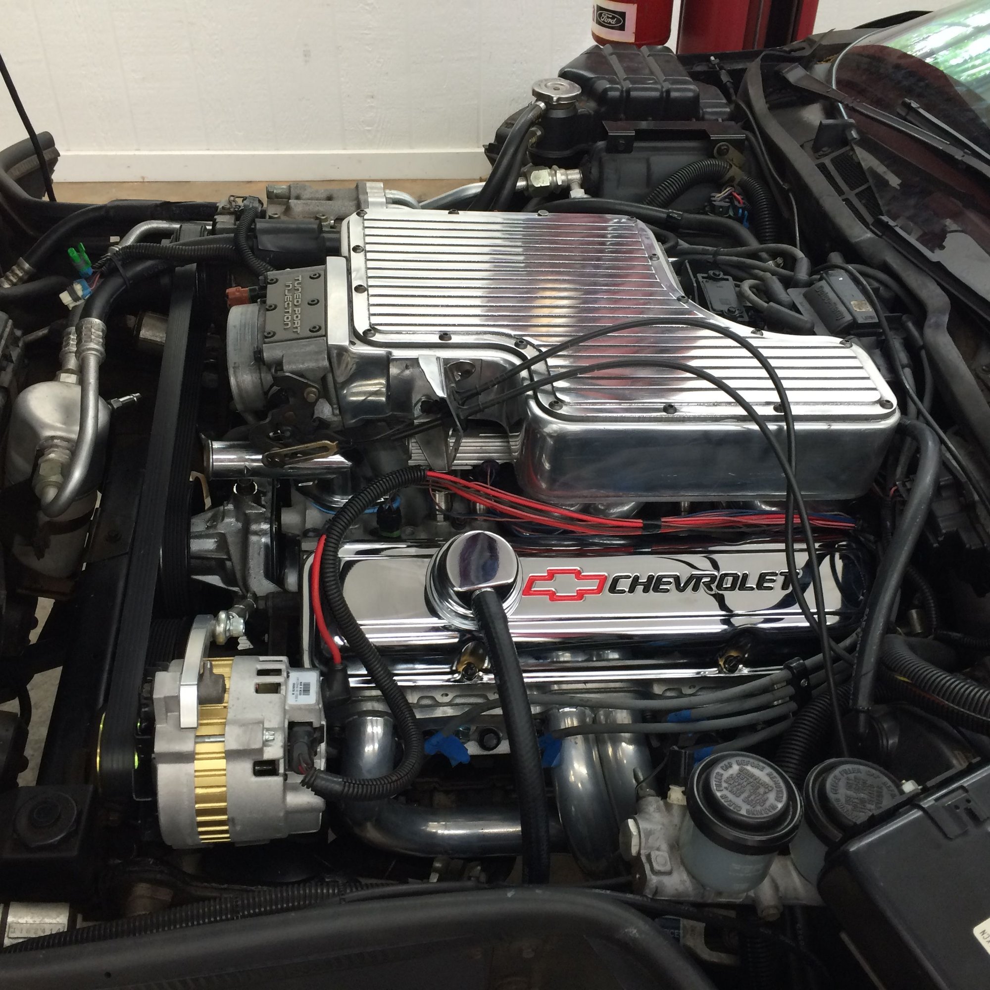

Does the throttle pressure cable run inboard of the runners, or outboard?( along the valve cover ) It looks like I will have to modify the throttle cable bracket to move the trans cable lower, and closer to the plenum. How have others done it?
Try it like the picture I attached. That was how I did mine when I had one.

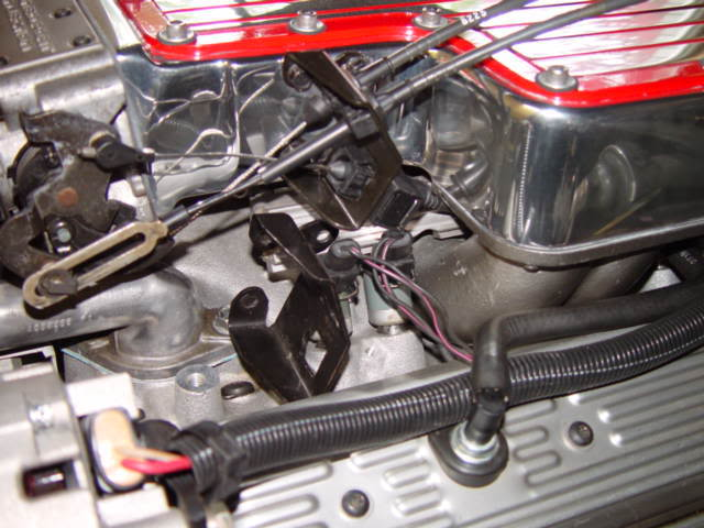

Thank you. Has the bracket on the manifold been modified? The bracket I have looks like the one lying loose below.

IIRC I used the one supplied

Mine is like the image shown, I used the supplied bracket.

Not sure i understand the idea of running the cable under the plenum as you could see in both pictures posted the cables run over top and around side of plenum and into bracket! But if you have to remove plenum, which I've done three times, use the suggestion of slotting the end of bolt but I purchased a ratchet wrench that fit the bolt, insert bolt in ratchet, the length of the wrench allows you to reach the interior holes and when to insert in hole you can see the slot from the top of plenum. insert a small straight blade screwdriver into slot and screw it in!!!!!!!!!!!!!!
There is a difference. The pic I posted has an auto trans. The other is manual. For auto, the kickdown cable has to go under
