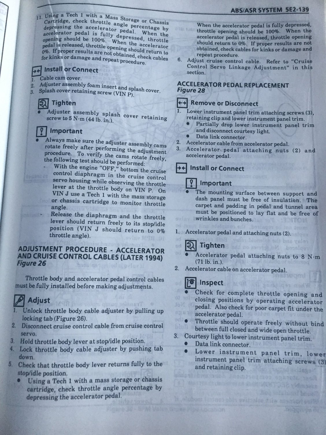

Do the asr cables ever need adjustment on a 94 corvette automatic transmission. I just installed a new throttle body and adjusted the throttle cable only. Do I need to do anything else.? The 94 asr system only has 3 cables connected to it and the throttle cable has the lever on it to release and slide it to adjust it correctly & take out the slack easy adjustment. The cruise and trans cable has no adjustment on it. Am I good to go like that? Thank you for your time.

Hey Big Darrell, here are the relavent pages out of the 94 FSM. Hope it helps you out.
That helped out alot thank you. I am new to the forum and still checking out how it works. I appreciate the info.

That worked car running great no issues. thanks
