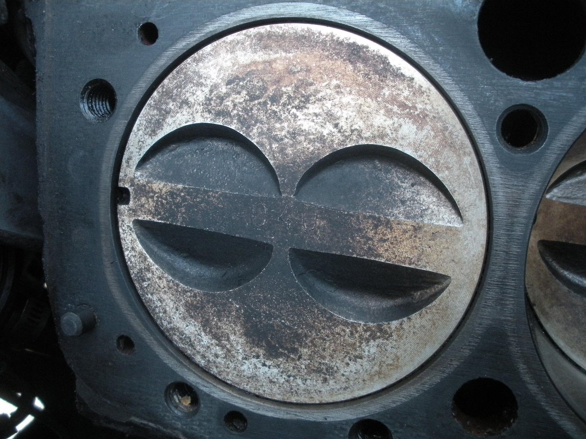

Can anyone tell me why the piston top would have more clearance on the exhaust side than the intake side?
Could the previous owner have decked the block this way on purpose, or possibly the Mahle flat tops were manufactured this way for extra valve clearance?
I've got around .010 below the deck on the outboard or exhaust side of the piston and around .040 on the inboard or intake side of the piston.

More checking of other pistons revealed there is that much slop of the pistons in the bore, now Ill check to see if they are in tolerance....now I feel stupid

..... The fact is : pistons are purposely not cylindrically round ... its not very apparent looking at them with the naked eye but if you looked at a piston from the side with the pin hole on center , it would have a barrel shape ... when cold ..... also , some forged piston alloys expand more than others and therefore need more piston to wall clearance allowing for more rocking in the bore ... again , when cold .....

I can't imagine that much "slop" is good. I sure can't see that in my '84! The '84 FSM specifies "production" piston clearance of 0.0025 - 0.0035, with maximum wear clearance of 0.0045. What are you identifying as the "outboard/exhaust/inboard/intake" sides, since the intake & exhaust valves are arranged e/i/i/e/e/i/i/e?
