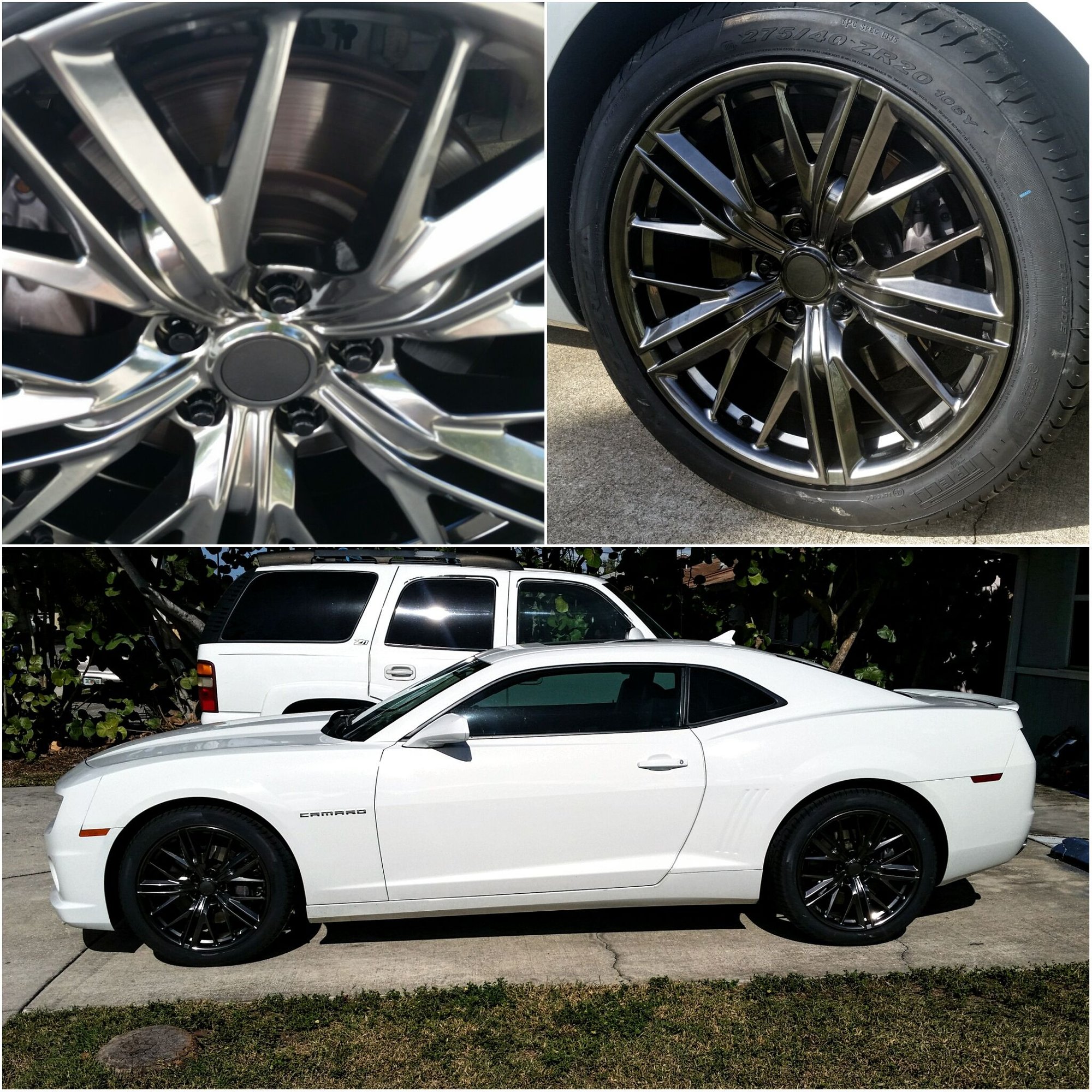

Originally Posted by OEWheelsTrish
Hey There,
I work at OE Wheels and wanted to take time to expand on the answer you received when calling in.
Most of our wheels are designed to give base model vehicles an upgraded look. That explains why they don't fit with upgraded performance brakes. Base models typically don't have performance brakes unless they are an aftermarket upgrade.
That being said, most of our wheels will fit vehicles with larger brake calipers WITH THE USE OF A SPACER. For liability reasons we cannot tell people to do that, however I will speak from experience and say that it can be done. I have a 2012 Camaro SS with factory Brembos. We received the new 2017 ZL1 Replica Wheels in around Christmas and had to have a set. http://www.oewheelsllc.com/CV25-2009...evrolet-Camaro I run those wheels with a 5/16 spacer in the front and no spacer needed for the rear wheels to clear. Again, we are not allowed to tell you to run with spacers, but I can speak only from my experience. It can be done and is done all of the time.
My suggestion is to order one wheel and do a test fit. As long as you don't mount a tire on the wheel it is returnable. I hope this helps! Trish
2012 Camaro SS with 4 Piston Brembos and OE Wheels
