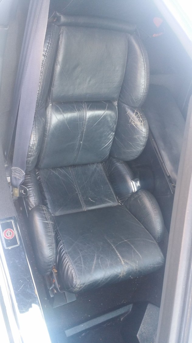

Yes, I can agree with that. My seats are comfortable in my 90. The driver seat was replaced with the "leather like" replacement skins before I got it. The passenger seat is still original. They don't match, the one is all shiny and the old passanger side is....... flat black? And it's brittle as a cracker. I'm scared someone will rip it.
Not bad for 280k miles and near 28 years
I really don't think this is real leather.
