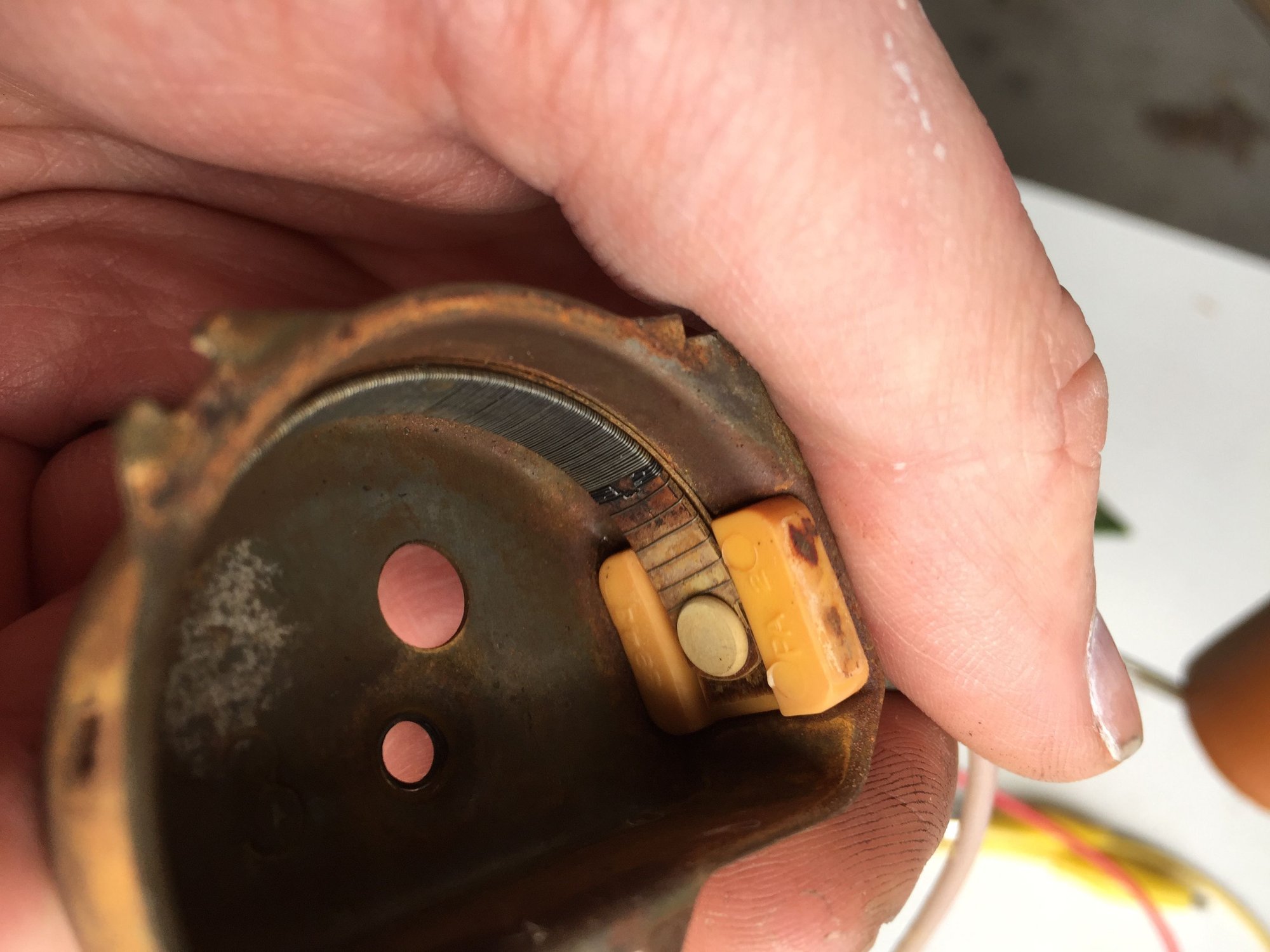

I think my winding is broken in my fuel gauge sender. Can it be fixed? I thought about trying to reverse it 180 degrees.
If not, any way one of these parts can be had cheaply? I don't need the whole assembly just the winding or possibly the housing with winding attached.

Well, I put a dab of solder over the affected area, and bench-tested it. I was seeing resistance correctly and it was only about 1 ohm off from factory-well within a reasonable difference. However, hooking it back up to the car, my fuel gauge still reads full all of the time. Is there something else I can check? Can I check resistance using the wiring harness coming out the top of the sending unit without pulling it out again?

You can short the sender wire to ground. That should send the the gauge to empty. As far as I know, solder won't stick to nichrome resistance wire.

So it turns out the gauge DOES work. Just took a little while to drop off. Drove about 60 miles before it started to go down. So anyway, dab of solder is a quick fix for a broken sender winding, depending on where the break is. I'd still recommend a new unit eventually, but if you're on a tight budget like me, it totally works.
