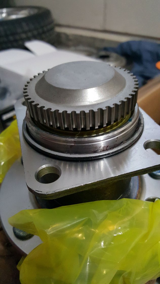

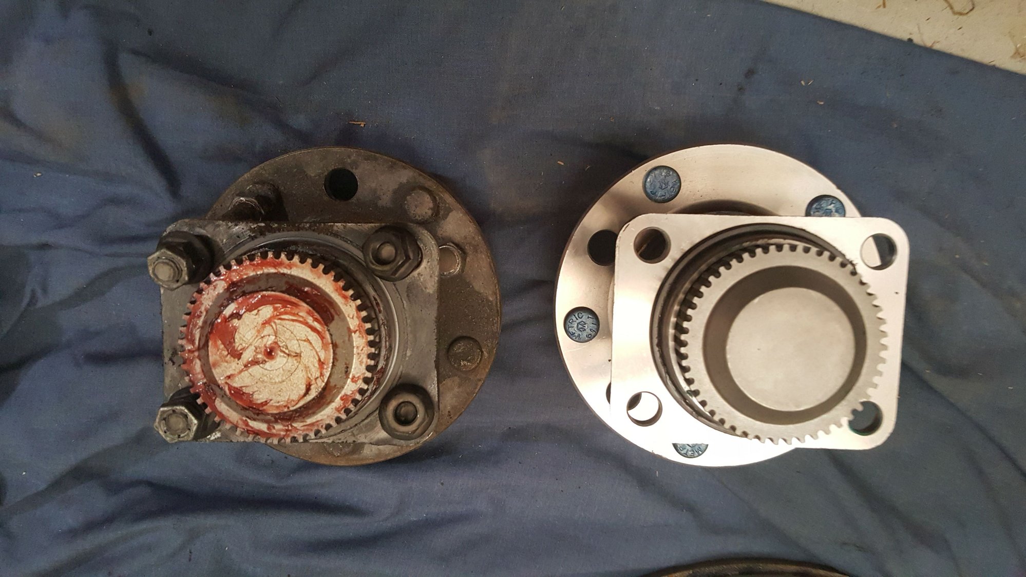

Hopefully these pictures make it easier to understand. I apologize if I'm over complicating this.
The first pic shows the old steering knuckle which has grease inside.
The second pic shows the old and new bearings. Grease is all over the old bearing.
The third pic shows the bearing with seal.
Am I just supposed to use regular wheel bearing grease and apply some on the seal and inside the knuckle?
Old Apr 15, 2017 | 09:42 AM
RF1's Avatar
RF1
Joined: Oct 2014
Posts: 94
Likes: 10
From: Tampa
The last guy don't know what he was doing.
The only grease needed is inside the wheel bearing.
If it were my car, I would clean everything up, check the knuckle flange for flatness, and dress it down with a file as needed.
I would put a very thin smear of antisieze on the bearing flange, and the 'nub' that touches the inside of the bore.
Torque the bolts, and call it done.

Old Apr 15, 2017 | 11:41 AM
c4cruiser's Avatar
c4cruiser
Joined: Dec 1999
Posts: 34,873
Likes: 487
From: Lacey WA RVN 68-69
Clean all of that red grease out of the knuckle. It's not necessary. Check the o-ring on the new hub and apply a very light coat of lubricant of the face of the o-ring. In the pic, it looks like there is a small amount of lubricant on the o-ring already.
Clean up the hub mounting face on the knuckle, install the hub and torque to spec. I like to use a small amount of anti-sieze on the bolt threads after cleaning them.
Old Apr 15, 2017 | 04:03 PM
jimmers's Avatar
jimmers
Joined: Mar 2005
Posts: 4,723
Likes: 11
From: Winnipeg Manitoba, Canada
Thanks for the reply everyone. I'll clean up the grease and leave it as is.
