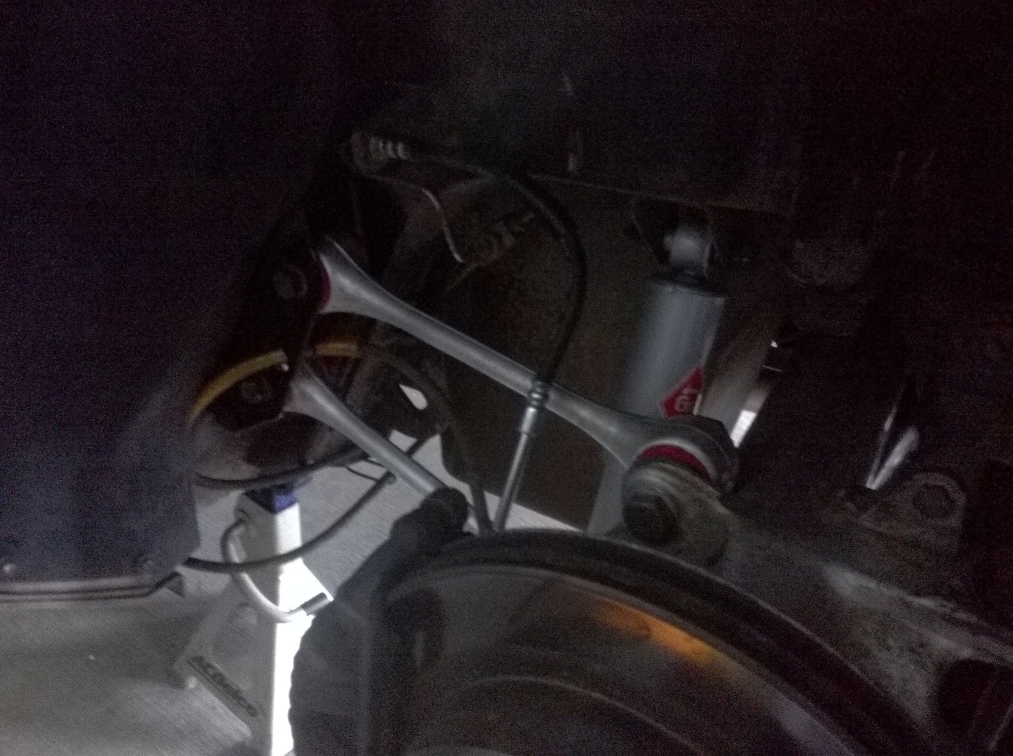

Old Apr 14, 2017 | 10:44 PM
xrav22's Avatar
xrav22
Joined: Mar 2013
Posts: 1,952
Likes: 239
From: Venice Cali.
Good tips made it much easier here's proof. Finally done with other side.
