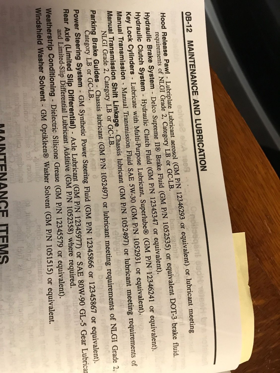

according to this, you need an additive for limited slip - BG LSII, PN 328 at a 10% ratio.
personally, I'd add in 4oz of the GM additive, however, FWIW, the FSM specifies 80W-90 GL-5 gear lube w/ limited slip additive - not 75W-140.

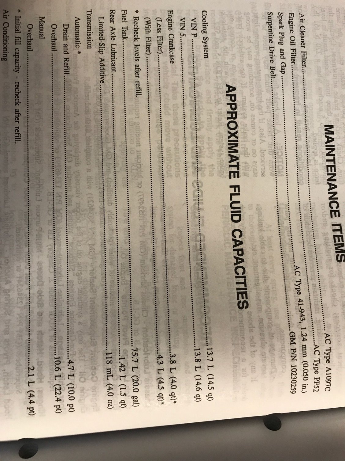

Thank you . I will print this off and take to the shop. Dan
Might want to print this these as well, straight out of the 96 Factory Service Manual.

Do I need the 75-140 weight removed? Thanks, Dan

I'd say MAYBE - you don't know for a fact what they put there so let them explain and comment. BG does have a product 751 that would maybe have been more appropriate, maybe that's what they used and their "invoicing" does the single feature on the ticket. That would seem ODD but who knows.
There's nothing in the specification that's been posted that it's an accepted product for the use BUT if they show you otherwise then ......
It's worth a conversation!! SHOW ME I guess works. Is their an application guide by vehicle that they use and can show you?

personally FWIW, i'd do it by the book. not trying to steer you in any direction, it's just my 2 cents.

Thank You all very much. I will pull it out and replace with the correct fluid and the additive. Too much doubt in my mind now. To answer a question from a few posts ago the cost was $99.00. I sure wish it had a drain plug. I am aware it can be added. Dan
