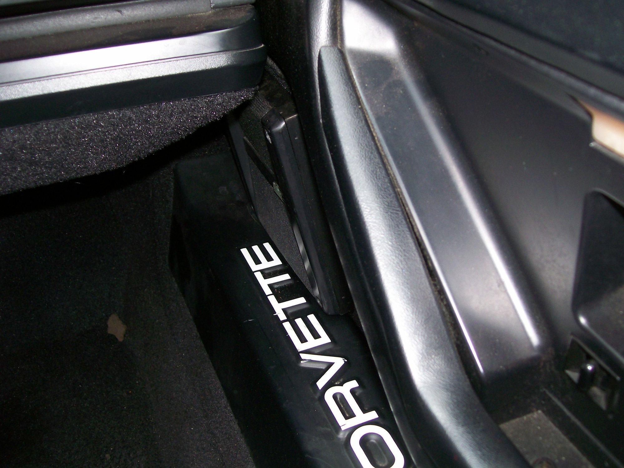

Got a pic? Just curious what it looked like in the earlier years. Mine was a 91 and it was a kick panel or whatever you called it at door sill. You had to remove the sill to do it. I changed the Bose bracket to a NON-BOSE option and picked whatever Crutchfield said would fit a 91 Corvette NON-BOSE. At the time, IIRC, my bicep, rotator cuff and elbow tendon (or was it ligament) was FUBAR so I got it apart and had them do the wire running. Left 3 feet of wire hanging out and I drove home. Installed speakers in the brackets, mounted brackets in and wired up. Rinse and repeat for all 4.

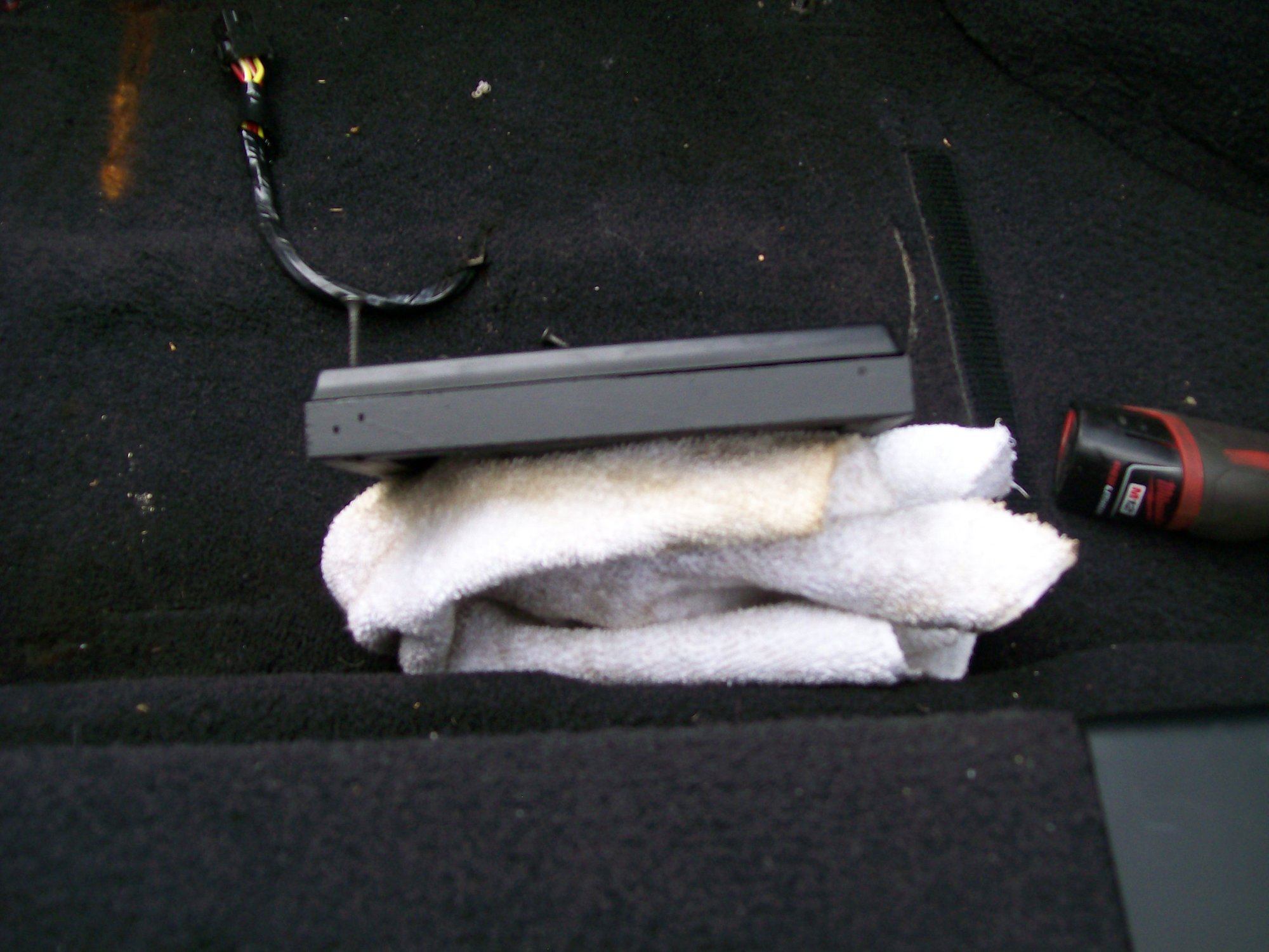

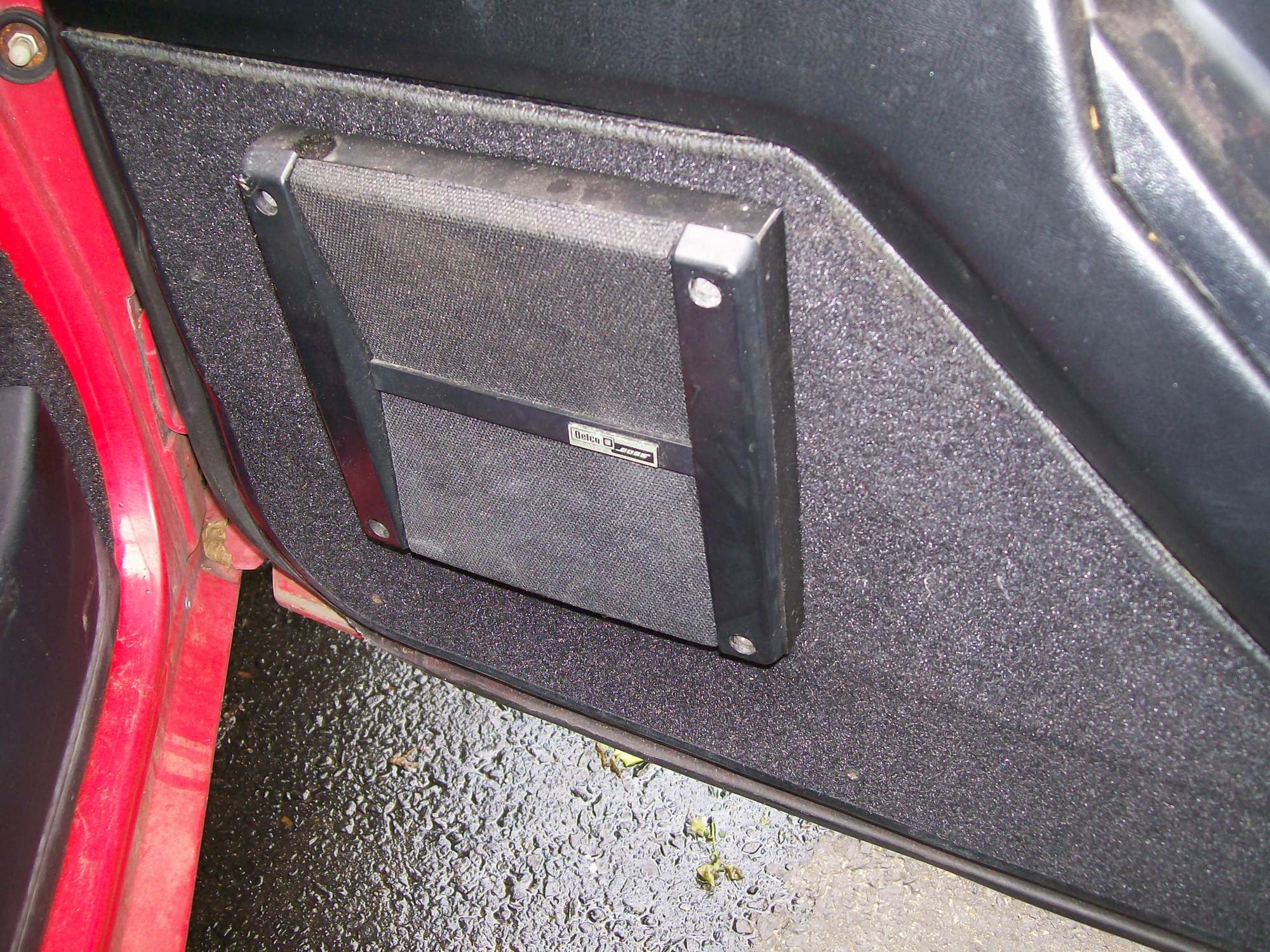

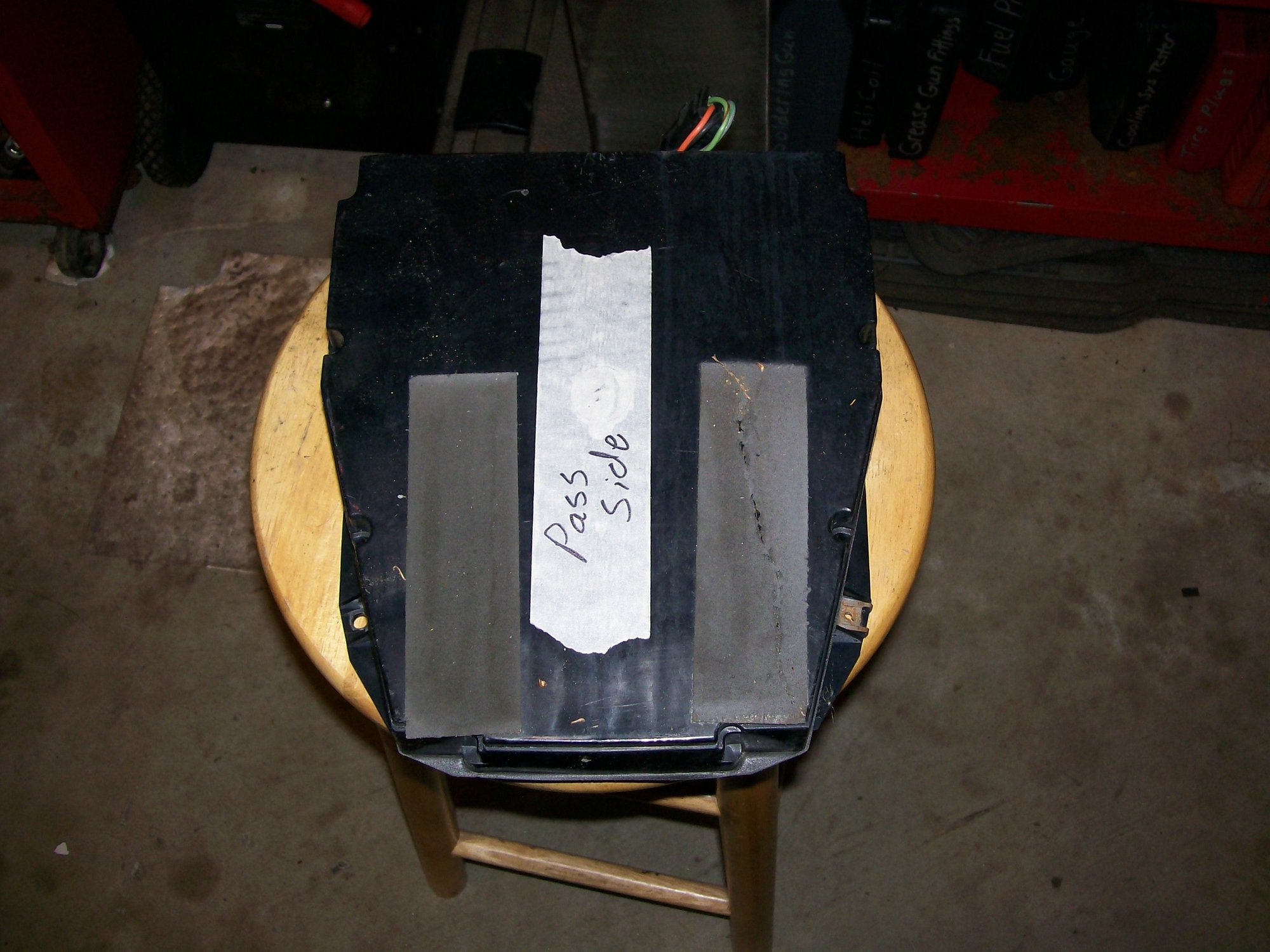

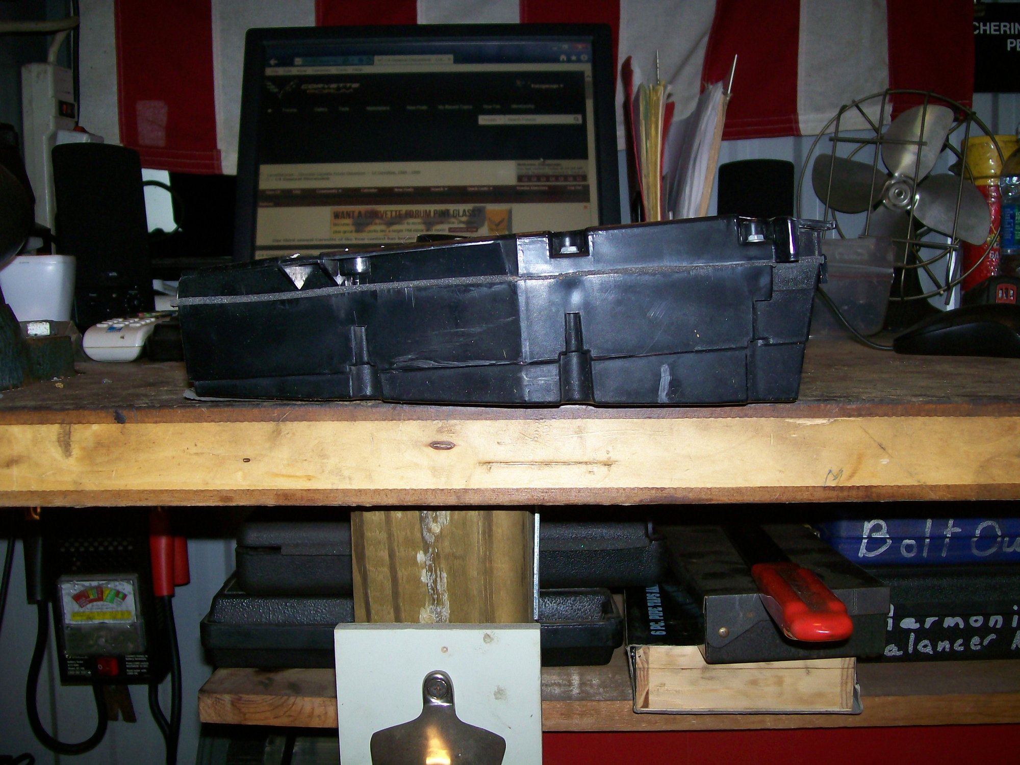

Are you looking for a pic of the speaker enclosure or where/how it mounts in the door ? I have the enclosures out of my 89 that I can take pics of if you want.
Both if you got them. Thanks

I have the enclosures out of the doors, I will post pics tomorrow. The doors are all sealed up, but if I ever have to take them apart again I will get some pics.

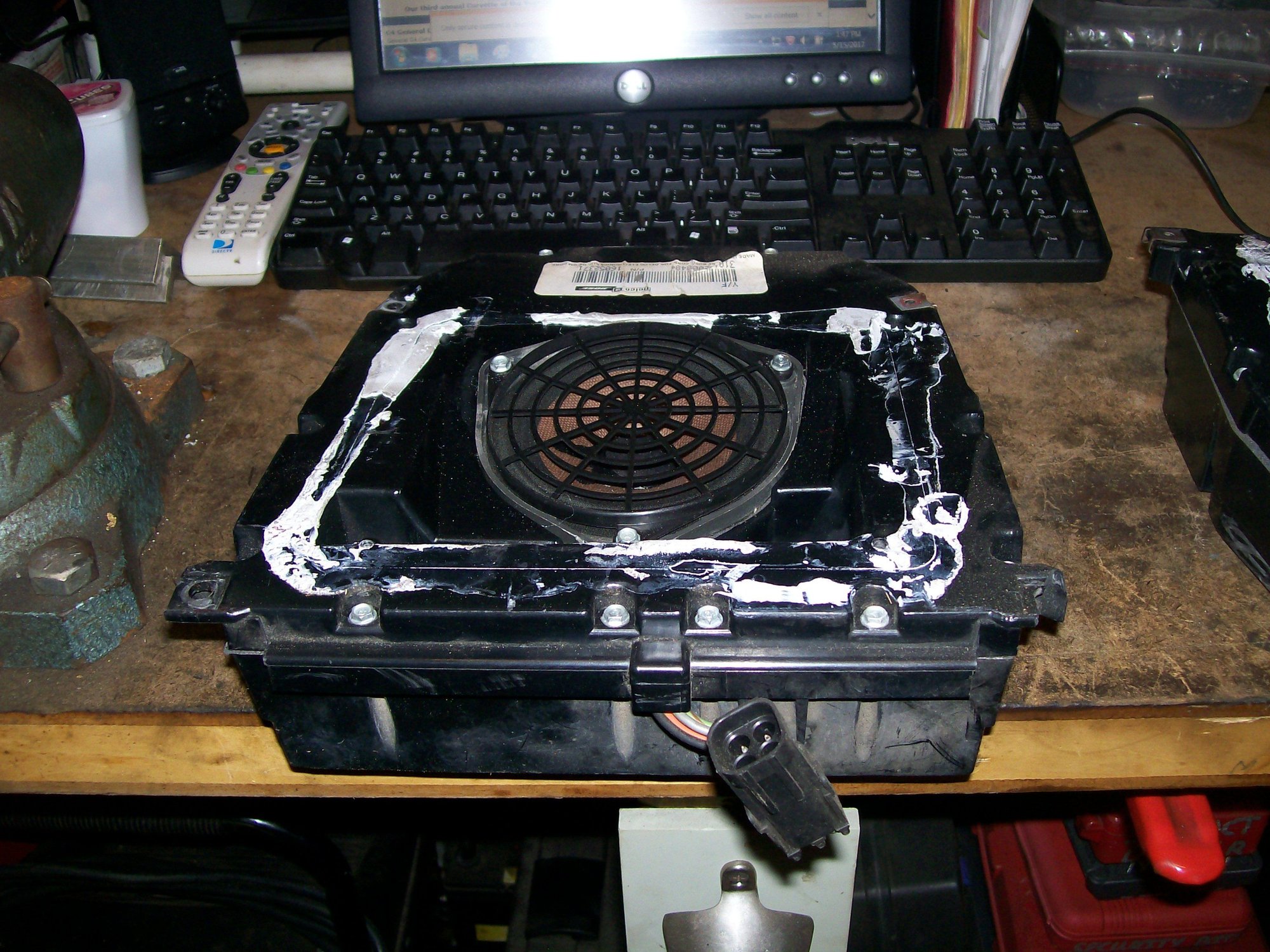

I don't think the white caulk is factory, the PO must have added it.
I think the foam strips are factory.

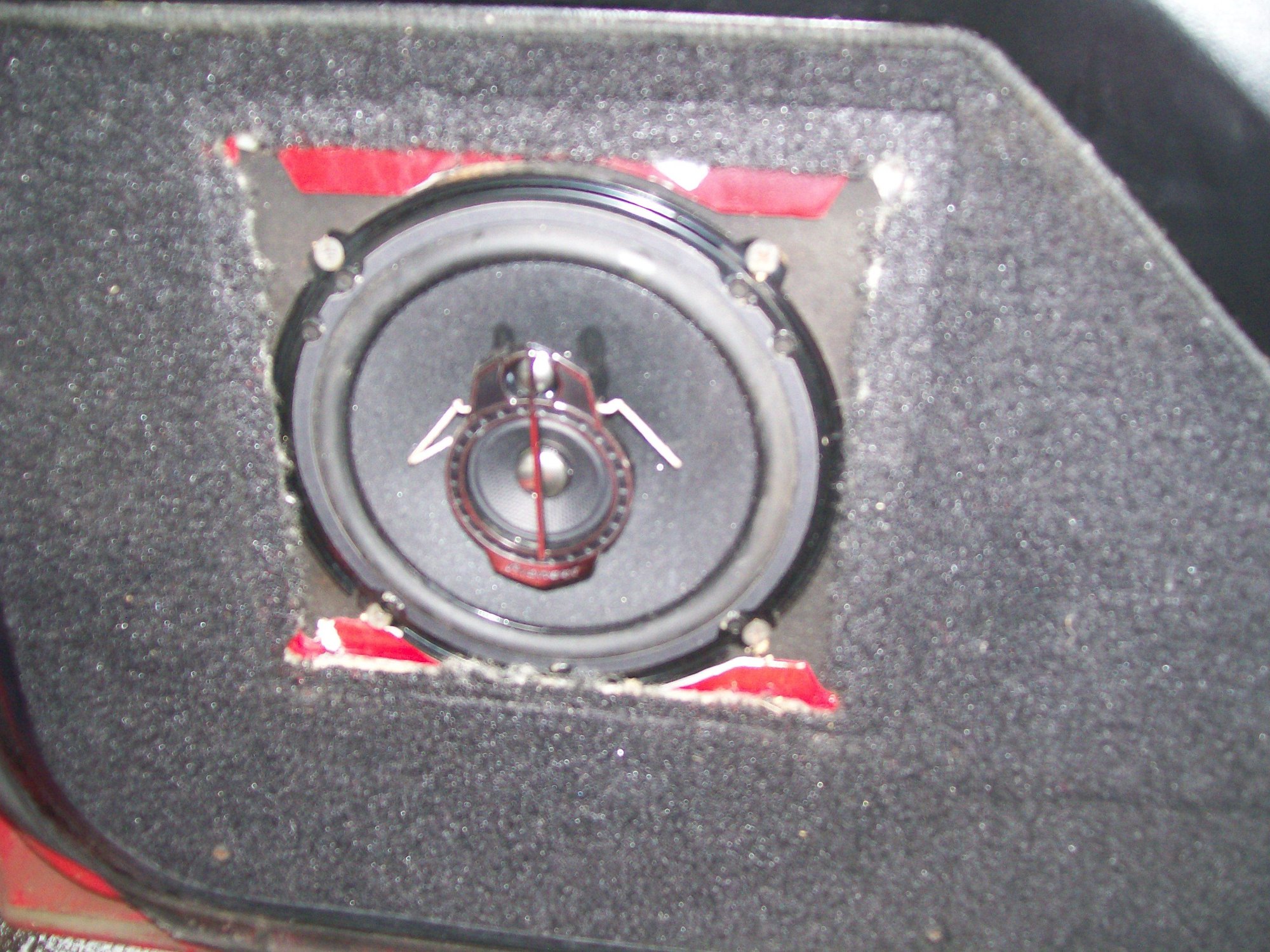

I made a wooden template to mount a 6 1/2" speaker in the stock location. I did have to trim the opening about 3/4" on the top and bottom to clear.
To clear the tweeter and keep the stock grille, I made a spacer out of wood.
Everything clears the dash, but just barely.
