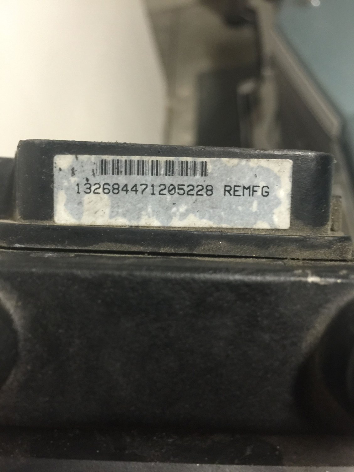

Since your TPI is from an "unknown" donor maybe diagnostics are going to be difficult for starters. There's very likely information on the MAF that could help ID the year TPI used on your engine. That would maybe help determining which diagnostics scheme to use.
Look for an 8 digit GM# on the MAF. If you're familiar at all with the donor mention that. If you've ID'd the relays previously maybe post the information on the relays also and that might help the ID of the TPI donor.
Blown fuse or fusible link would be "first thoughts" for the NO CEL - how the TPI was done on your car needs to be determined. If it was done by a "specialty harness" most of those were done based on the 1227165 ECM - if you know where the ECM is and you can retrieve the label information from the ECM and maybe the PROM it might be able to help you better.

Assuming that the TPI was installed using most of the original wiring. Check your fuses for maybe ECM but not knowing how it was done CHECK ALL FUSES! Even the original H - engine would have used an ECM and had a ECM fuse.
Good Luck!
Barcode on the REMAN isn't much help!!
