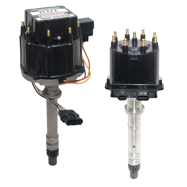

Thanks...what's the "Distributor 4-way connector"?
It's a 4-pin wide connector. The wires come out on the back passenger side of the distributor, though I believe the wires run from there to the drivers side where you can unplug it. I've only unplugged it while removing the distributor which gave me easy access to it.
*Also glad you saw that in the FSM, I forgot to mention it in my previous post.
Thanks...would you have a pic of that connector? Or maybe if you know where it unplugs from? Thank you!

I just drove the car so the engine is a bit too warm to stick my hands in there and play with it - but here's a photo of the wires:
You want the group of wires on the right side running parallel to the spark plug wires, you can see that there are four of them. The connector on my car is just under the distributor, but the wires are long enough that they could be anywhere behind there. I said they go to the distributor on the back of the passenger side, but it's almost exactly on the center/back of the distributor.
Here's a picture showing the connector:
Okay, yea...I remember those! Thanks, I had a different one in mind. The pic helps a lot!
