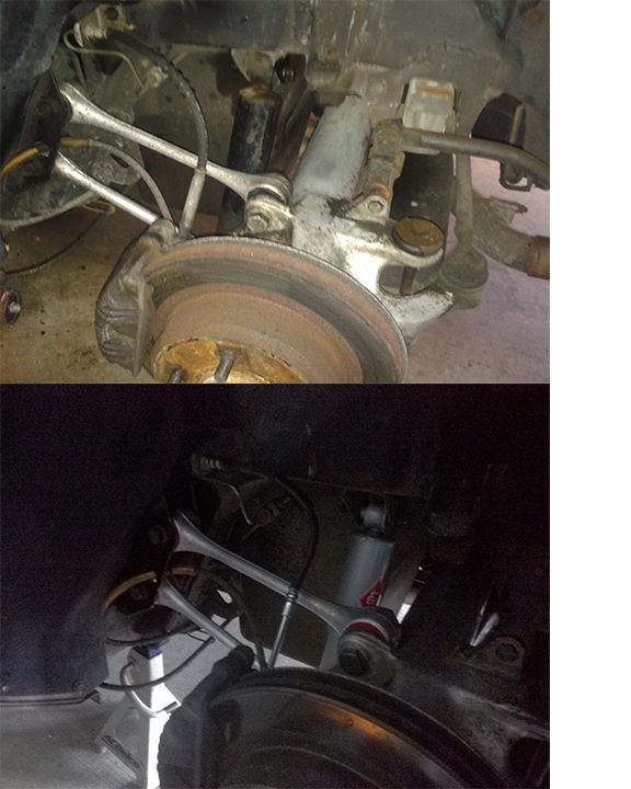

Kind of what I was dealing with here is a before and after. Note
Very hard to tell if the ujoints are bad because the spring is tensioning them inward.
Strut rod bushings are hard to tell if bad because you cant see them.
trailing arm bushings in the pick looked ok but they were pushed all different ways.
jack the tire and try to move it 3-9 and 12-6 to check hubs.
Now that I have most replaced I learned it is better to do the ones that affect alignment the most first. I have been to the alignment shop 2x and one more trip should do it.
Good luck
