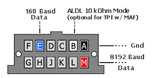

I would agrre with cleaning the connectors with sandpaper and electrical cleaner(safe for plastic) not a wire brush unless you disconnect the battery. Then put a dab of dielectric grease to keep it clean for months to come. I replaced all of my important connectors with new ones. don't forget about the mafs female connector and you can use the electric cleaner to clean the maf. My headlights have failed because of the dirty connector. Heres a pic of the alcl
