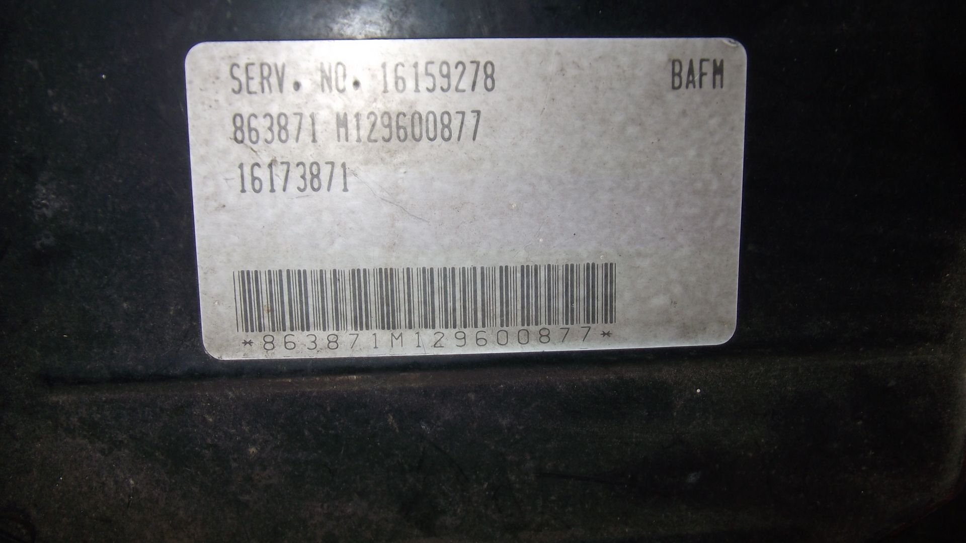

Originally Posted by Ian67
Getting back to it. If the ECM is dead, other ECM's with the same serv.no. are ok to fit? What are the other numbers for on the id label? Or don't they matter
You only need to concern yourself with the "SERVICE NUMBER" - Other information on the label is the OE/ACD original assembly that would have included the actual PROM. 4 letter code is the "as built" PROM ID, the 8 digit (line 3 - I think) is the GM assigned number for ECM w/PROM. Line 2 should match the BAR CODE and is internal ACD/Rochester control information I'd think.
If you've a relationship with someone here in the states I'd maybe consider having that person originate the buy of a core maybe and use a repair facility that someone has used in the past.
If an LT1 owner would handle the buy/repair and confirm operation in their car maybe that would be a wise decision and I'd expect to pay reasonably for their assistance.
Maybe post a snapshot of your label, confirm that your PROM is an OE match to the label and move forward. Posting the snapshot might catch the eye of someone parting an LT1 car and offering up the ECM for a reasonable price.

This is the label on my ECM

ECM information indicates this is a 3.07(G44) car. If all of that matches I'd be shopping one of them maybe here in the states. Maybe try a WTB in the parts section and see what happens.
ECM only requires a match of the SERV# 16159278 which would be '92 & '93
See what the scan reveals. The scan is going to be done with what hardware and software? Ask and maybe post back!
