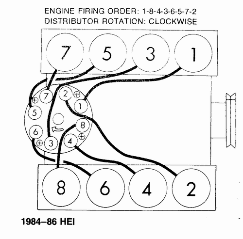

TPS should go from about 0.5 Volt to 4.5 Volts.
Firing order correct?

Double checked if not triple checked.
