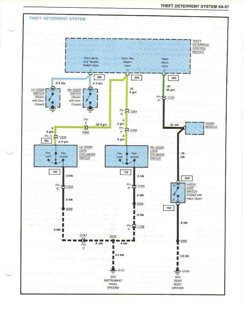

Unlock door with key to disarm.
Does the engine crank over? The theft deterrent system will disable the starter.

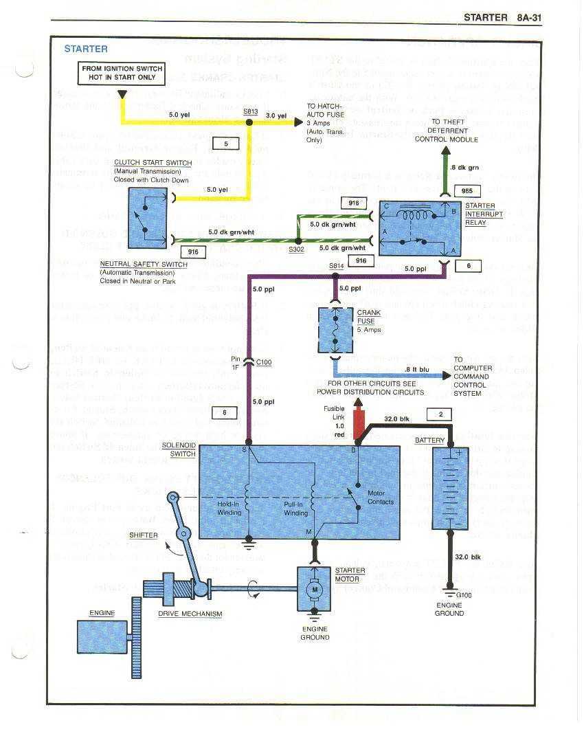

Thanks for the diagrams. That should be helpfull if I have to bypass the security system. To your question, no the engine does not crank.

Originally Posted by Adam2980
The door locks work fine. I tried that. Locked it un locked it, by key and by power locks, No change.
There is an extra switch up in the door lock for theft deterrent. If the actual key locks work does not matter. Unlocking with power locks will not disarm.
Try with the key on both left and right doors.
If you open door, lock with power locks, the security should change from flashing to on. Close door and it is armed.

Likes: 13
check to make sure that green wire with the white stripe running to the theft deterrent starter interrupt relay has power to it on pins c and d when the key is in the start position. If it does not, you have a different problem, like a neutral safety switch. my manual seems to show the relay on the passenger footwell, but I have not gone looking for it yet.
