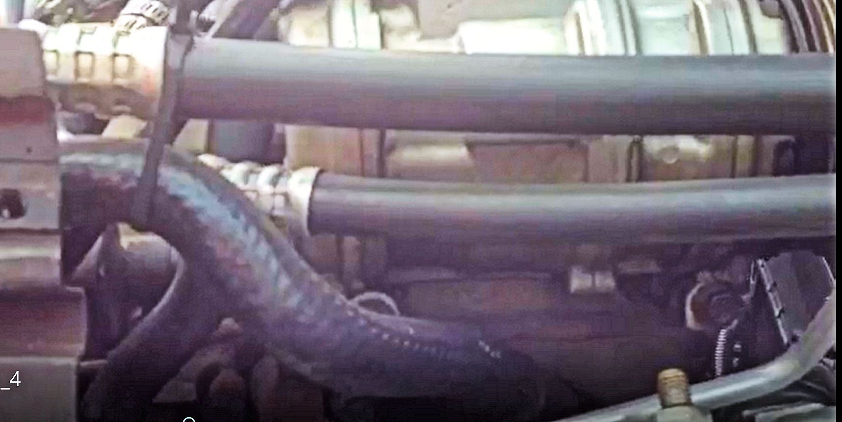

Originally Posted by oldgringo
Question 1: Should the compressor be removed from the mounting bracket first, and if so how? I can see four long bolts mounting compressor to bracket but can only access top two without using multiple tiny ujoints to remove bottom two (and then how do I replace them once new pump is installed)
I replaced my WP about a month ago on my '88. 1st, I took off the front wheels to lighten the load on my back [I see you referenced your chiropractor].
Here is a pic of my lower bolts of my AC compressor, I removed the wheel well inner piece and had clear access to lower bolts [I think that's what you're referring to.
