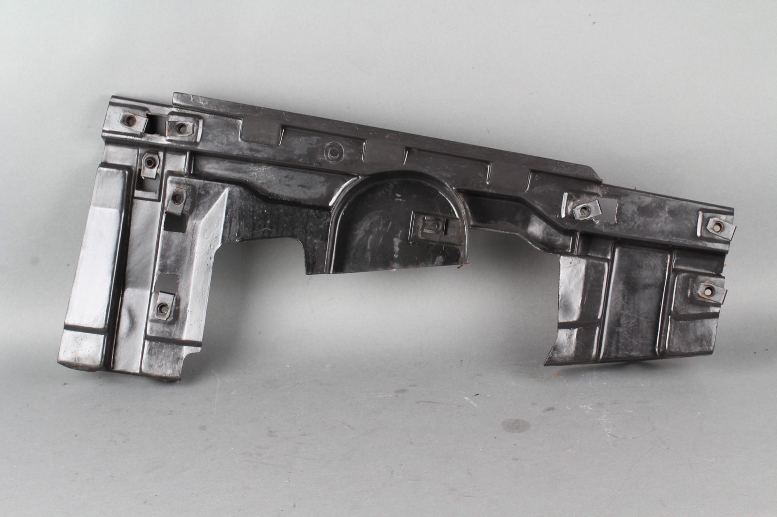

It must be parts from different years. Probably a newer hood.
Look at theese inner fendes, pictures from ebay. The newer is much higher and would probably close the gap. Replacing the inner fenders on the hood is probalby easier and better.
1984-1987
1988-1996
Old Jul 12, 2017 | 11:07 AM
I think you are on to something here.....
