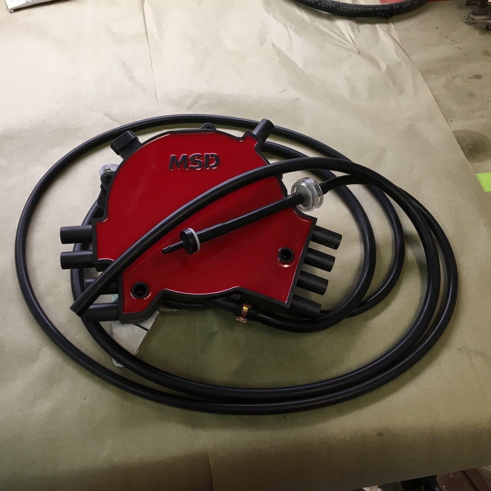

One thing about the Opti is that the low-priced versions are just that; cheap in price and quality. It will cost, but tell the shop you want a brand new AC Delco Opti. Some C4 owners have tried the MSD Opti and it seems like that one is not as good as the AC Delco version.
A leaky water pump especially where coolant drips out of the weephole at the bottom is an Opti-killer. Get the shop to install a new WP while they are in there. The WP has to come off anyway. The vented version is also a good idea, and so is adding a drain hose to the WP weephole.

There is a guy on eBay that uses MSD housings with original NOS Mitsubishi optical sensors. Look him up (Type in Mitsubishi Optispark). That is what I would buy if I needed an opti right now.
Even tests them prior to shipment.

there was a design flaw in the 92-94 - they need a custom vent added like the later gen 2 95-96 style.
if you dont add the vent, then yes even a genuine ac delco opti will fail.
i also question whether this poster really had a genuine ac delco optispark bc they havent been available from the dealer in 10 years. (that said, you can still find them on ebay, junkyards, or parts for sale sections of many forums - the vette wasnt the only car that used the lt1)
if you go to the dealer and ask for an ac delco optispark, they will give you a remanufactured in china optispark, in an ac delco box
so there is a lot of confusion about what is a genuine oem new old stock ac delco optispark
