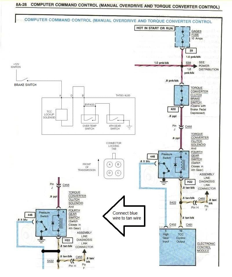

To automatically activate TCC on fourth gear without computer. Connect blue wire to tan wire on the trasmission connector.
It will not fix your other problems.
