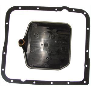

in the middle of a transmission service but old filter doesn't match new one. I got a Duralast TF300 from Autozone. It's a different shape, it has the uplift tube more centered on it rather than biased to one end. Anybody run into this? Did they change the design? Didn't want to try fitting it in case I need to return it.

Looks ok to me but sometimes the wrong filter is in the box.Make sure to pick out the old red oring seal.

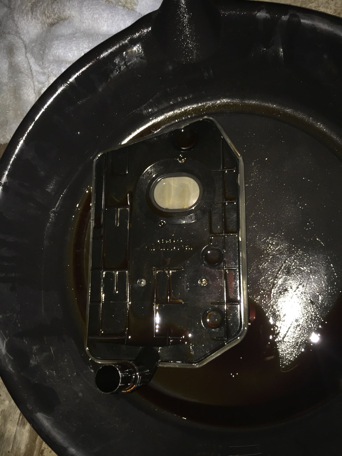

Here it is, mine has one on the right but one on the left is what is called out and I believe what Eckler's sells

Here is a picture of mine, sure looks like the AC Delco TF234, I did a search but nothing comes up. Has anybody run into this?

Every 700 I ever opened up had the filter on the left there. The one pictured in post #2.
If there's another filter, I'm not aware of it. I probably have three on the shelf downstairs.

Little bit surprised it will fit, as the neck looks considerably longer.
This isn't some hill jack work around for a deep pan, is it?
I believe you have the wrong on that is for sure.
Here is a 200-4r kit it is not for 700r4.

I believe I've seen the 4L60/700R4 filter used on the 200-4R but never the other way around. I believe it's used because of the "pick-up". Just return it OR did you just go ahead and use it? It's difficult to determine from your posts if it's installed or not.
Maybe someone wanted the 700R4 for his 200-4R bought both and returned the 4L60/700R4 box and gasket with the 200-4R filter. People do stupid things to swindle the sellers.

Apparent 200-4R filter top
Bottom
No, I pulled a 200-4R filter out of my 87. I have a 700-R4 ready to go but was a bit confused by what I pulled out. These are photos of what I pulled out this afternoon

Your post#12 helped considerably. I thought that you had received the 200-4R maybe in the 4L60/700R4 box and wanted to question packaging.
*** I did some reading regarding your issue and I believe that until the AUX valve body was added the 200-4R and the 700R4 actually used a very similar filter.
Between '84 and '88 there were 4 different part#'s for the filter from GM. '84 (1), '85 & '86 (1 and different), '87 (1 and different from others) then the '88 which is what we're most familiar with.
Your old filter has some information molded onto it. What is that information.
Could this maybe be an '87 original filter?
Here's what's mentioned as NOS for an '85 & '86 Corvette and catalogs actually mention '82 thru '87 for some

Only info I saw was a patent #.
I sure hope this wasn't the original filter😳
she's a little clunky going into gear, especially reverse but pretty smooth once driving, still got life in her. Planning to switch to synthetic ATF and will probably do a second Chang in a 1000 miles or so to really make sure it's flushed then get on a regular schedule with it.
