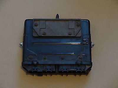

Old Jul 7, 2017 | 01:38 PM
JimLentz's Avatar
JimLentz
Joined: Jan 2014
Posts: 2,478
Likes: 254
From: Downers Grove Illinois
Near the top of this picture with the 4 screw referenced in post #4 above.

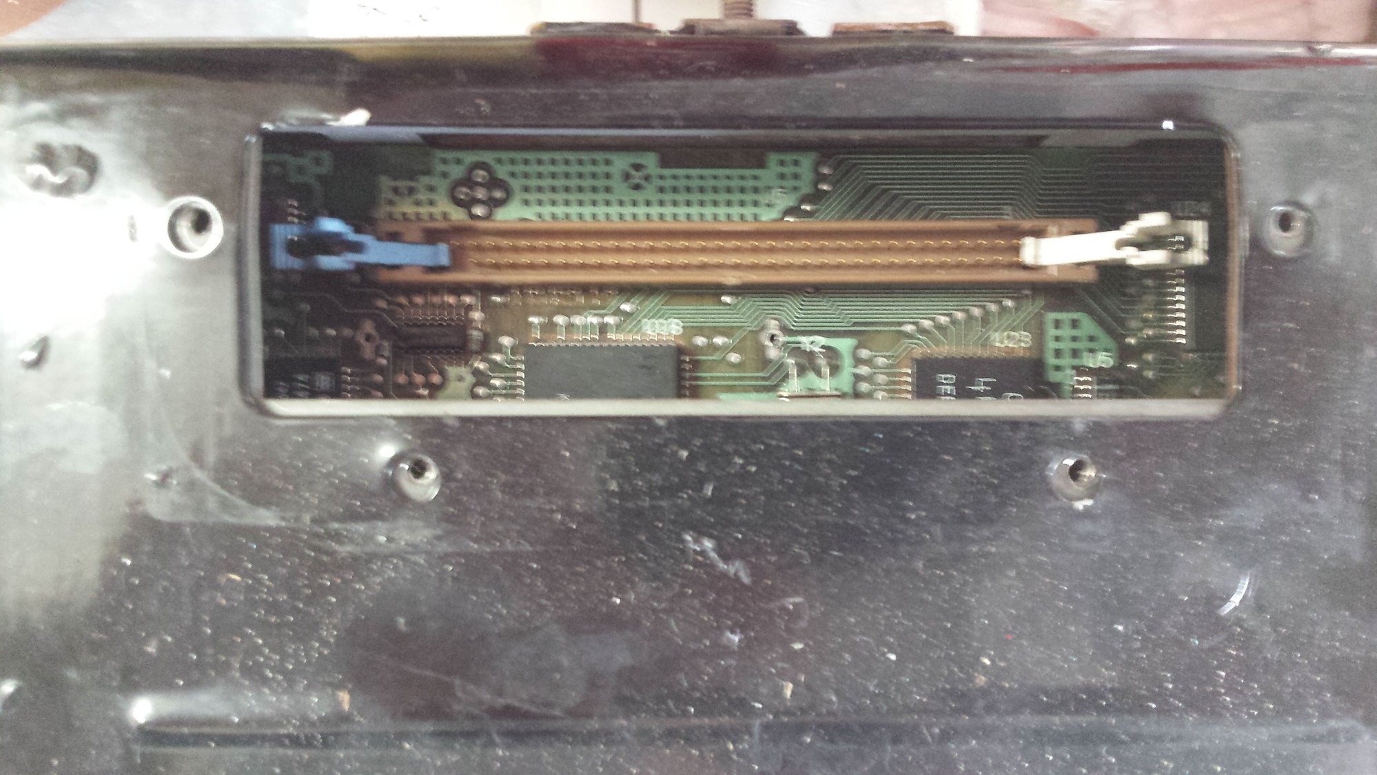

Old Jul 7, 2017 | 02:40 PM
s carter's Avatar
s carter
Joined: May 2014
Posts: 2,895
Likes: 592
From: New Port Richey FL
In this picture the Prom/Chip is missing, it fits in the brown slot between the blue and white tabs
