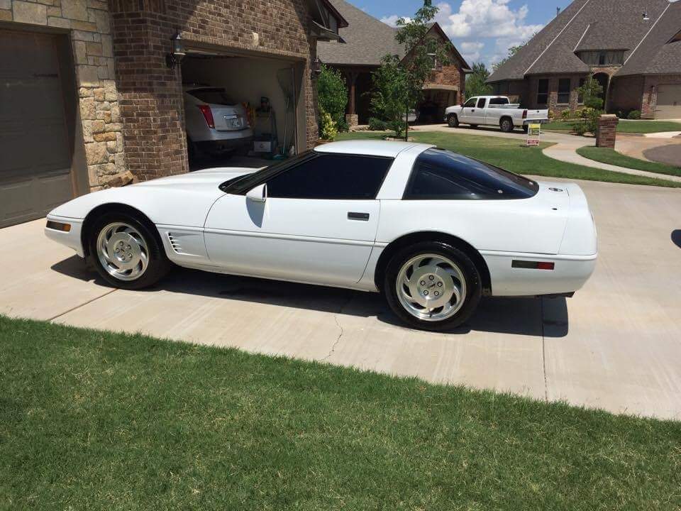

Default How do I know if I need shocks??
I am loving my c4!! Got my first complement today.
My vette has 70k on it now, how do I know when its time for new shocks?? It rides rough in town... but its a vette, rough is a relative term.
Will a new set of Billsteins soften this up?
I have a 1995 base model.

I also have a 1995 base, white, looks exactly like yours. Very nice.
