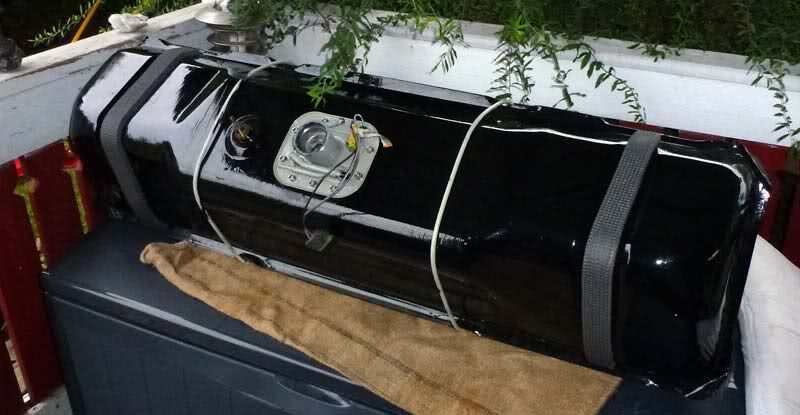

POR15 and many other companies make "fuel tank sealer" -products which you can use on an aftermarket tank to make sure it "never" rusts from the inside. Remember that water is heavier than fuel and collects to the bottom of the tank slowly corroding it.
Painting the outside with epoxy or POR15 type paint is also a good idea if you plan on keeping the car for a long time.
Doing both will make the tank last a lifetime.
I used a original GM tank with the plastic liner still in good shape so I only painted it outside.
