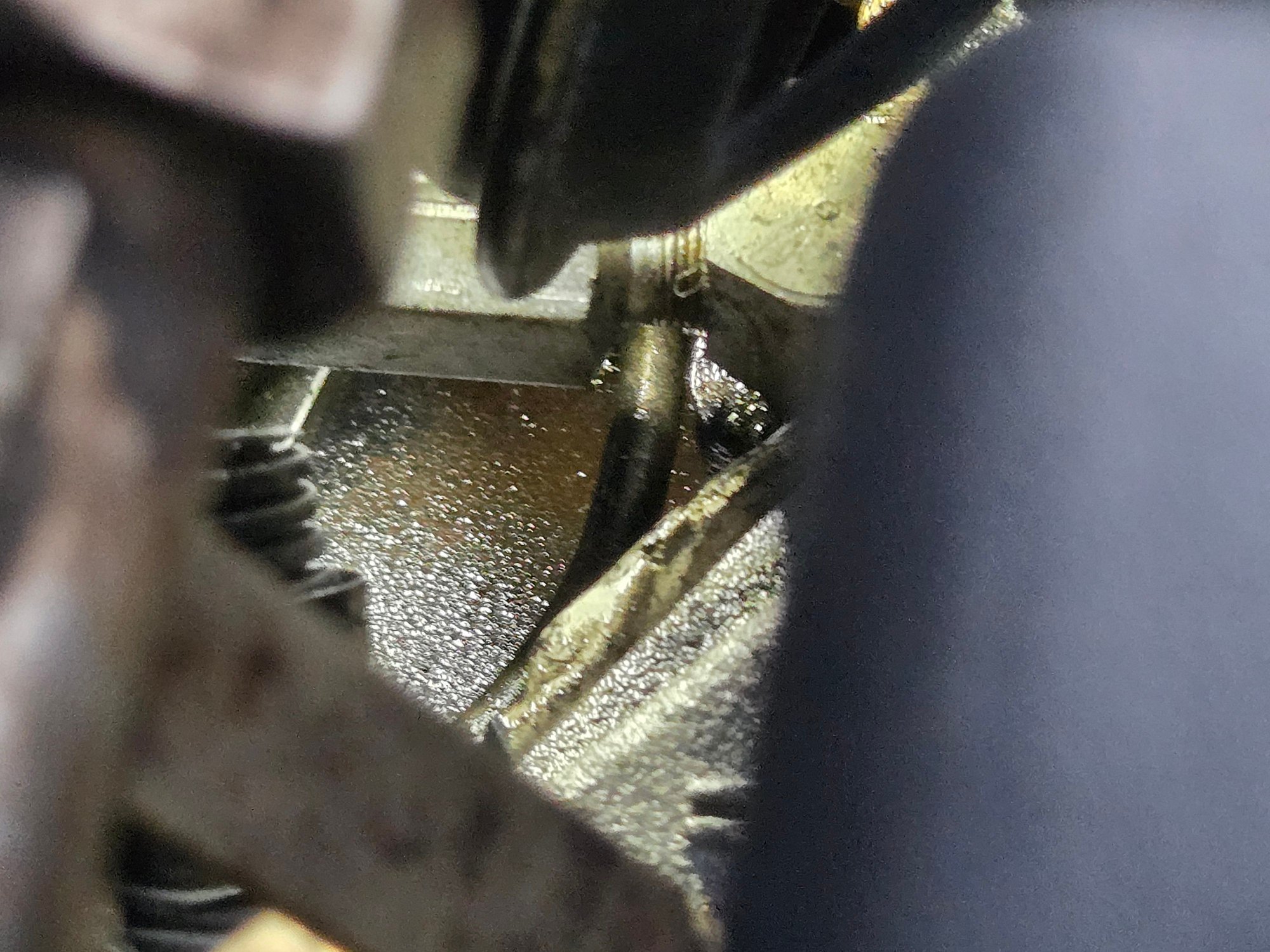

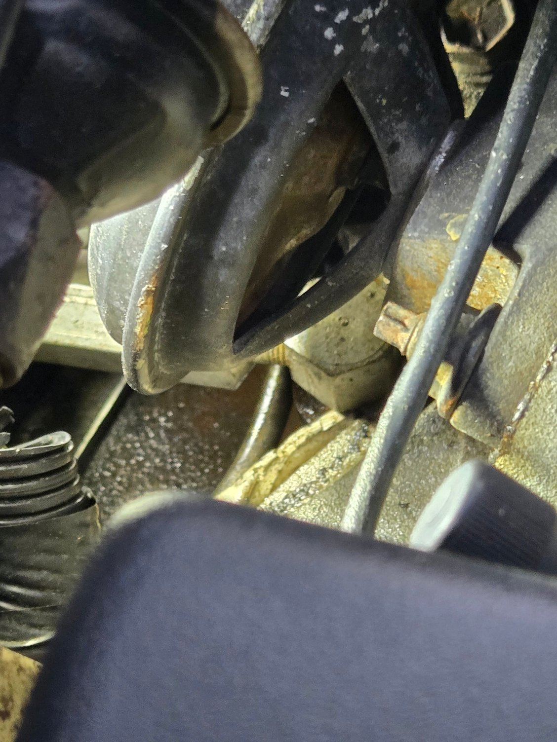

I realize this is an old thread, but adding to it and will update it later today or tomorrow with what I find. I have a very similar oil leak on my 95 LT1 with 76k on the clock. It's leaking high up and going down the block to the exhaust. I hope its just a valve cover gasket or sensor like the one above, but if its the china wall, then so be it and I will get it fixed. I will post back with info when I remove parts and see what is causing the leak. Hard to see in the photos I took, but there is a film of oil on the back of the engine, leaking from somewhere..
