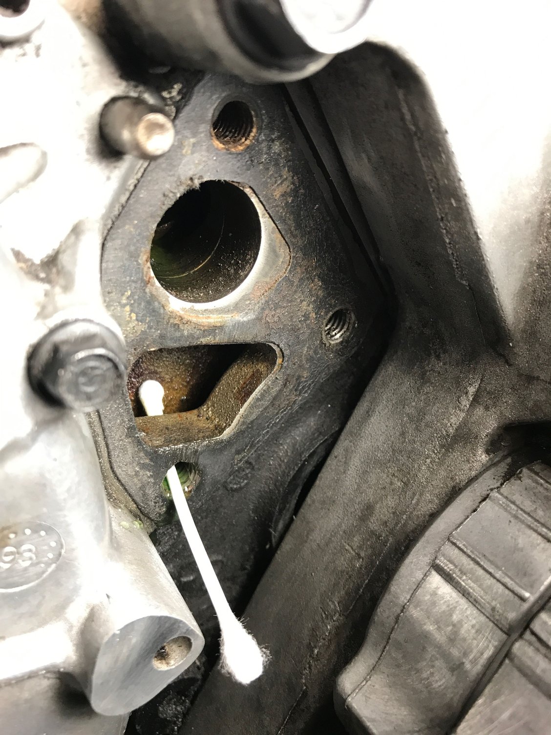

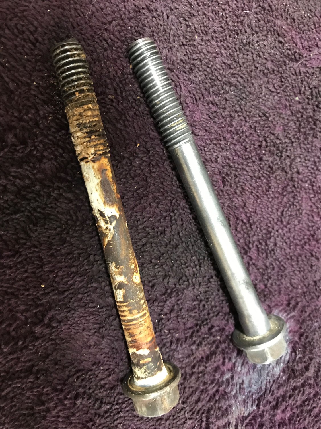

I previously posted about the opti failure DTC16 that I had this week. I started taking apart my 94 LT1 today. New Sac City opti on its way.
There were no real surprises. Both the opti and water pump drive seals were leaking oil. Not too badly but will replace both. The balancer was a royal PIA but it finally let go.
I have a couple of photos and questions for the forum.
This is the post on the ignition coil. It, along with the inside of the plug, were badly corroded. It almost looks like something was applied to the post and it lead to the corrosion. It cleaned up ok and will continue to use it. I'm replacing all the wires. Thoughts?
The second photo shows two of the water pump bolts, before and after cleanup. It looks like the bolts were plastered with plumbers sealant prior to installation. Not sure why. I can see sealant being needed on the threads but what a mess.

You'll probably be okay re-using the coil if the post cleaned up perfectly. If you have any doubts, just buy a new one. I'd go with OEM, if replacing.
The sealant on those water pump bolts is there because the holes they thread into are drilled all the way through to the water jacket. In the absence of thread sealant, they'll weep coolant. Be sure to reapply before you install those bolts.
And, do yourself a big favor by applying some anti-seize to the damper before you put it back on the crank hub. You will thank yourself (or the next guy will thank you) next time it must be removed.
Another suggestion is to test-run the engine for a few seconds after installing the new distributor and wires, before putting all of the rest of that stuff back on the engine. If there's a problem with the new dizzy or wires, you'll be glad to learn of it while it's all still readily accessible.

Given how easy it now should be for you to remove the damper should you need to, and the fact that its purpose is to reduce harmful harmonics, I'd install it before starting the engine. It's only three bolts. If you've cleaned up the rust at the damper/hub interface surfaces, and applied some anti-seize to the damper's bore, it should always be easy to remove in the future.
RTV will probably seal those bolt threads adequately, but given how far buried they are, I'd go with a good quality thread sealant instead just to be sure they remain well sealed.
Gen 1 SBC, true. But bolt holes on the LT1 are blind. I just did mine....checked 'em before I slathered my bolts w/sealant. I ended up not using any sealant, b/c there is nothing to seal.

[QUOTE=Tom400CFI;1595408187]Gen 1 SBC, true. But bolt holes on the LT1 are blind. I just did mine....checked 'em before I slathered my bolts w/sealant. I ended up not using any sealant, b/c there is nothing to seal.
I just checked the water pump bolt holes. The only one that passes through into the coolant passage is the driver side, lower hole.

[QUOTE=Drifter36;1595409932]
Over the 13 years that have gone by since I've done mine, I'd forgotten which one(s) it was. That's the one that'll need a good thread sealant.

Yep. You found it...I missed it! No leak so far...but fingers crossed!

I was fortunate when I remved the pulley as my neighbor had the LT1 factory puller that is shown in fsm.
Cleaned up bolts and used never seize on threads and sealant at the bolt head part of the bolt.
