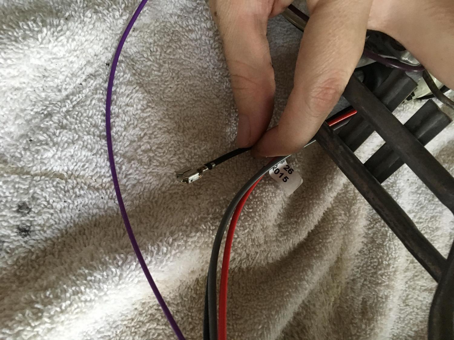

So now that I have their kit, I see it eliminates the EM/RFI filter, which I suppose is fine if newer pumps have that installed inside anyway.
The factory connection is pressed in from above into the hanger that holds the RFI filter, how best to replace that, and how is that extra ground best removed/re-attached with the new? Not a wiring guru. I guess I could butt splice.
The connector to the pump also has an extra ground coming out of the connector, to what?
Ground to?
How to best remove and install new?
