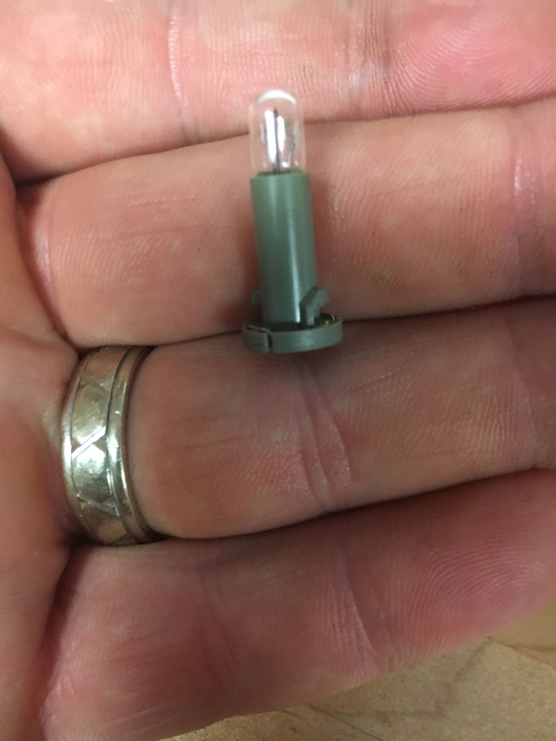

Hi all. I am going to be pulling my climate control unit out tonight and attempt to clean the contacts because not all of the buttons are responding. I have read a few threads on this and it looks like everyone has had success. My question is what bulb lights up the digital display on this unit. It's obviously burned out because there is no back light but I can still see the digital read out. I was hoping to pick up a bulb today before I pull it all apart. Any help would be greatly appreciated!

This is the answer I was looking for. I hope this helps someone in the future. I did the cleaning on my circuit board and now ALL of my buttons work perfectly! Just need to pop the new bulb in when it arrives and she is good as new!!!
