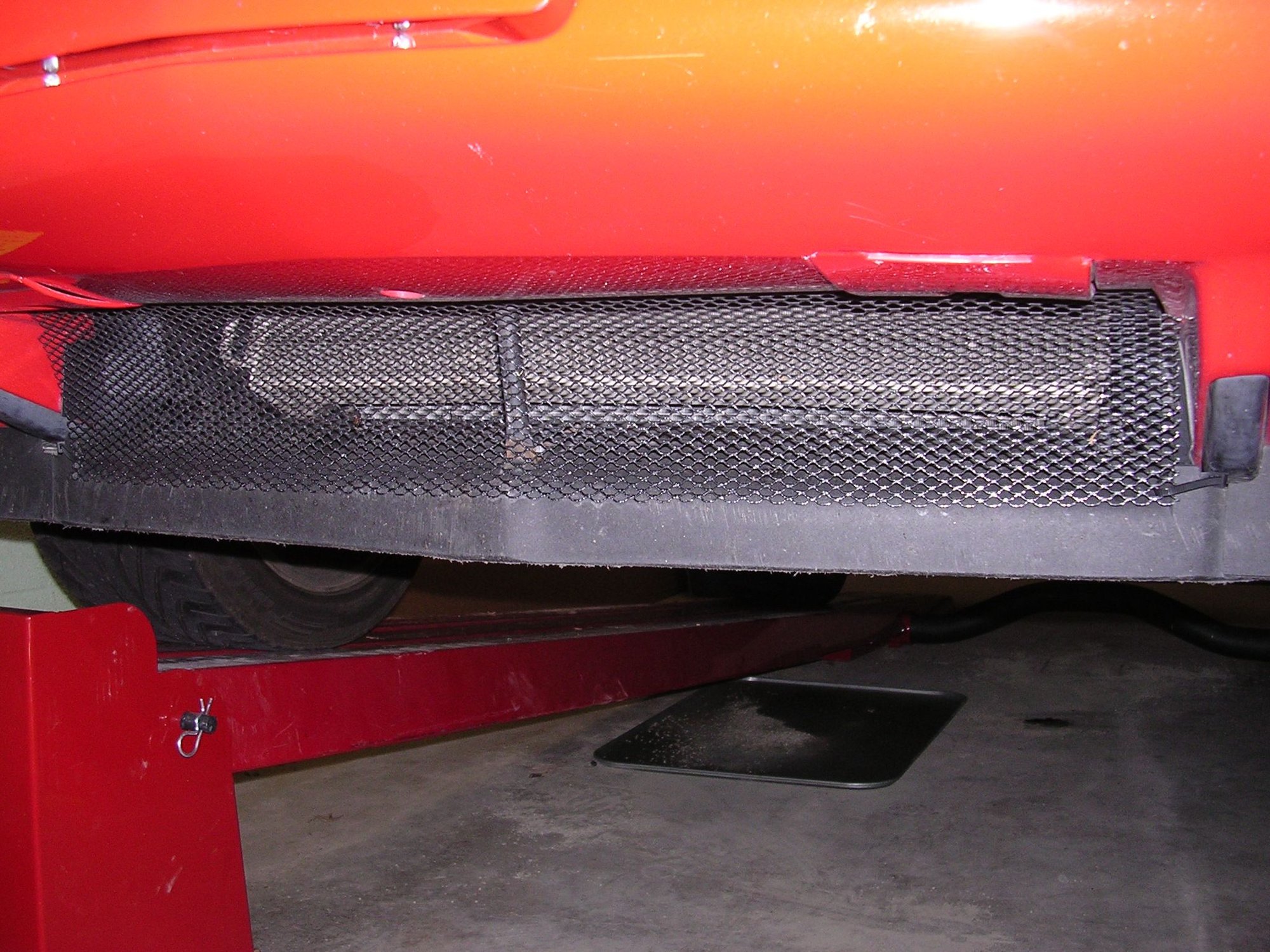

Those temps are normal, but not necessary. I run a 160* thermostat, and have re-programmed the PCM to lower the fan on/off temps to 190/180 primary, 195/185 secondary. The car runs much cooler now, typically around 180 at cruise.
As others have noted, these cars are bottom-feeders, and they will suck an astonishing assortment of crap into the cooling stack. Clean yours out, and consider adding a screen to stop the majority of debris before it gets in there:
