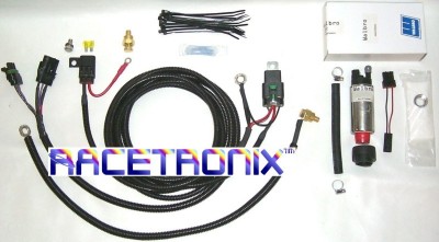

You can test your fuel system to see if it is keeping pressure by pinching off the return line to the tank AFTER the system has been primed and the power shut off. If the injectors are leaking down or the pump's checkvalve is not holding you will see the pressure drop off.
If your car has the original injectors it would be a good idea to send them out and have them cleaned and flowed. The other option is to replace them as most RP injectors of that era where not that good. The injectors can become contaminated which can cause many problems. If they have many miles on them the springs can become weak as well.
Racetronix has a promo on now where we will clean and flow your injectors for $10.00 each. We will replace the screens and o-rings if required.
We also have Delphi injectors on sale if you decide you would like to replace them.
We also have fuel pump systems on sale for your C4.

I bought one of your KITS for my 87 Buick WE-4 *aka GRAND NATIONAL* and found a big diffrence in power. But this was for a turbo car so. This car i think i just need to replace the pump wit an OEM replacement or something. Havint the injectors tested and flowed isnt an option for me im not sure about any of the other guys, because my vette is my daily driver. Not like i can pop them out and send em off. But i liked the fuel pump that i bought for my Buick Grand National thanks
