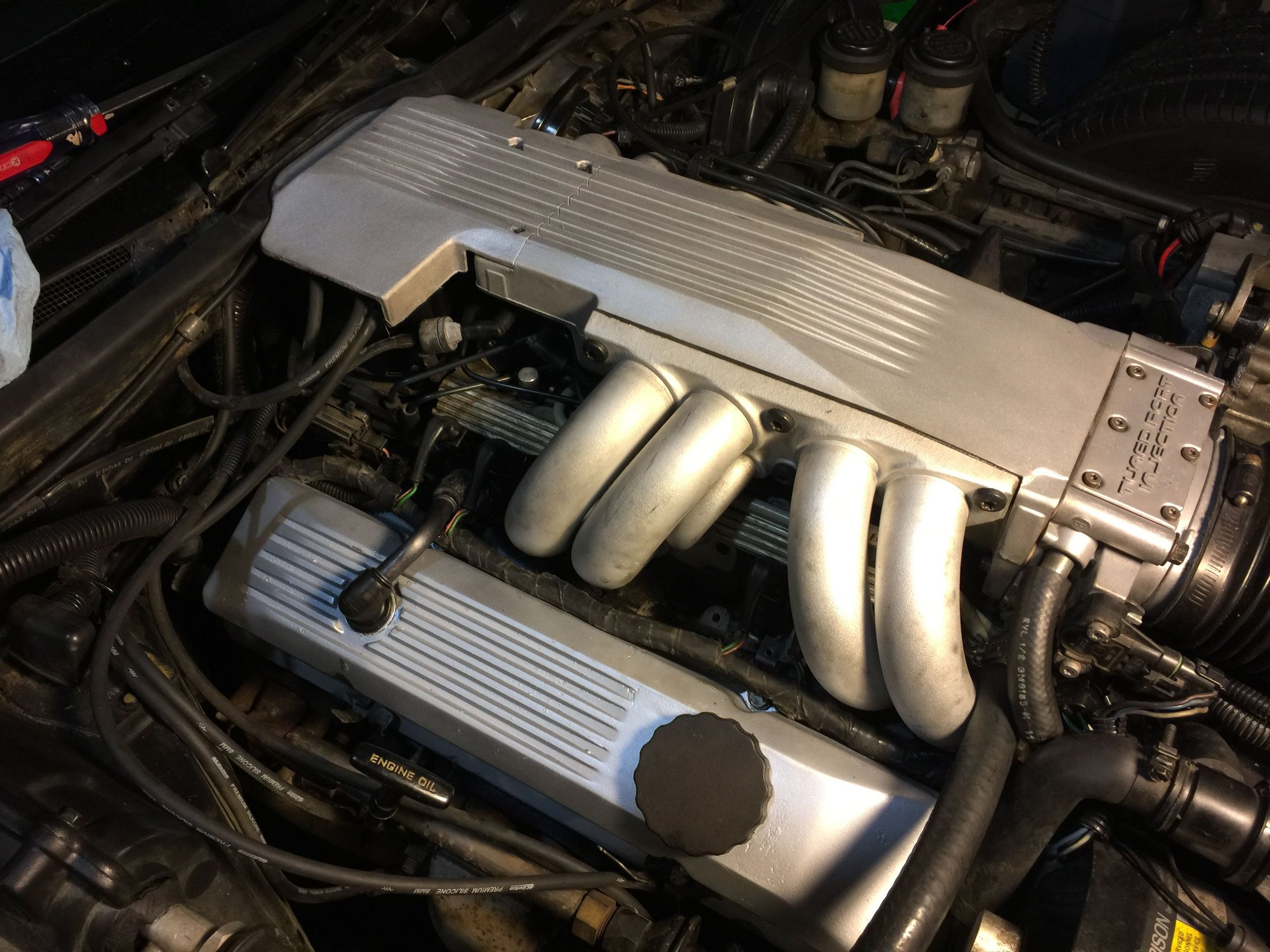

Started the tear down today. Got the plenum off, throttle body, passenger side intake runners, and got stuck on the drivers side runner. I can’t get the rearmost bolt off-can’t get a wrench in there. I think I’ll take the smog pump off, so I can take the valve cover off, so I can take the wiper motor off, so I can reach the bolt. Gotta love this stuff
havent run into any more difficult bolts. I’ve been taking my time and using the acetone/atf mix to break them free.
Taking the smog smog pump off is proving difficult-you have to take the wheel off the front to reach the bolts, and two of the bolts holding the wheel on are stuck tight. I’ll soak them overnight and try again later.

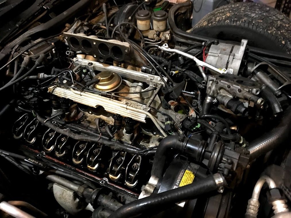

Just thought I'd share another progress pic-almost have it down to the manifold. So far I've still been able to get most of the bolts out without too much fuss.
Looking' good so far.
That engine needs more frequent oil changes. You see all the sludge/carbon casting the top of your heads (inside the rocker area)? That shouldn't be there. It's not alarming...just an FYI.

Thanks for the advice Tom-I just bought her so no clue what maintenance was like before. I’ll be sure to keep oil changed though. Soon on my list is transmission and rear differential fluid changes, too. Want to start fresh and know it’s done.
I think the welder was mostly worried about getting his vice grips on and breaking it free. I’m happy he’s willing to admit when he’s not comfortable with something rather than diving in and screwing it up. Since I was planning a tear down like this anyway, it’s not really even much of an inconvenience honestly. I’m happy to be pulling things apart and seeing the condition of parts this way. Just taking a while. Wanted to get an early start. He’s coming Saturday but didn’t want to get stuck on something without the time to work through it.

One friendly piece of advice... Based on how the rocker arms look - it's a pretty safe bet to say that the car was not very well maintained. I'm betting that applies to the cooling system as well. Since you are going to be installing fresh coolant after pulling the intake - go the extra mile, and after you reinstall the intake - pull the two block drains and let everything drain out. You'd be surprised how much crud some of us have gotten out of our C4 motors when the block drains were pulled....
If you really want to go nuts - pull the two heater hoses, and do a quick flush of the heater core as well.
One last thing - you're certainly on the right track with changing out tranny and diff fluid - but I'd strongly recommend Adding Brake Fluid to the list of fluids to be flushed !!! It's arguably the most important fluid I the car !!!
