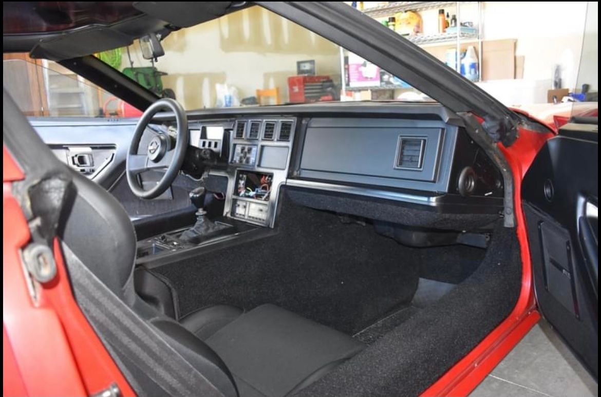

Sorry for the delay in replying back. Some pics below from the breadbox delete and where I switched the red interior over to the black.

Would you be kind enough to let me know how you unfastened the heater box please? I'm removing the interior on my new to me 84 to get rid of all the mouse fouled carpet and padding. I'm at the firewall and the pad is toast. I'm stuck on the heater box at the moment, scratching my head trying to figure out where all those darn fasteners are in the engine compartment. Thanks, ***** T

They should be a blend of fasteners coming in from the engine bay and there is one or two that go into the firewall from the interior side. I found it easier to unbolt the box in two pieces so I could see better. Also, had to put the car up on stands to get to some of the bottom fasteners out. Hope this helps

I have an issue with my 90 convertible wire harness that had been altered because the fuel relay had been removed ? why who knows I don't .So because of the reason that I can replace the complete harness to make the car safe and hopefully eliminating some constant on airbag lamp and intermittent abs system lights.. I have located a harness and the only issue is That it has a harness side for a passenger power seat mine does not. Your pics with the disassembly gives me some comfort knowing it is lengthy but doable project to say the least. Great images ! Dan R.
