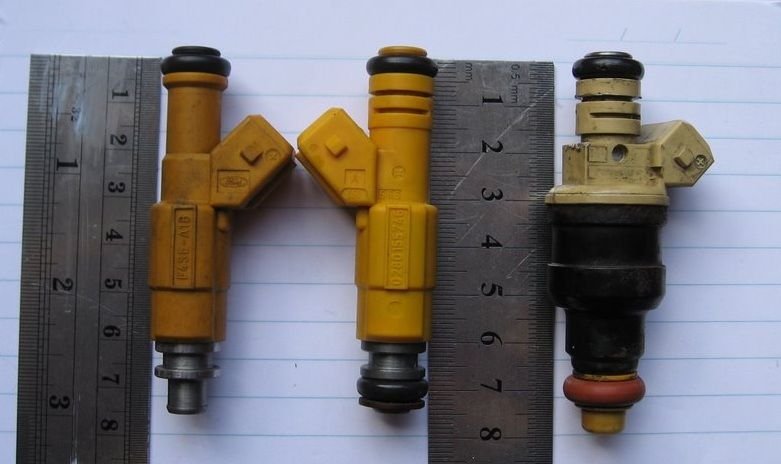

Hi
the Bosch 111 injectors are shorter than the original injectors, they can slide down into the inlet manifold injector recess.
The original injectors larger body hits the manifold preventing the injector from popping out of the fuel rail if a retainer clip breaks.
You need 2x o rings at the bottom one at the top
(one above the normal lower o ring recess) the second "top" o ring will look bigger outer diameter when fitted but stops the injector being forced down by the fuel pressure. It works trust me I have been using Bosch 111 injectors for around 8 years, no leaks.

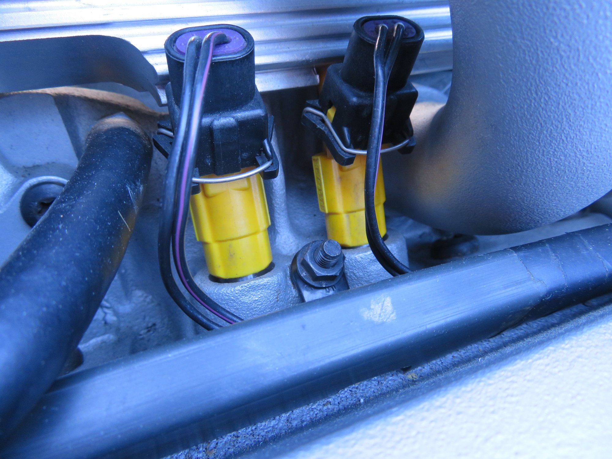

that is odd - got pics?
the yellow injectors is what i'm assuming everyone is referring to as boxchIII's. note, there are different configurations - applications, unknown. do you recall what design you have? my boschIII's all came with a secondary bottom o-ring. that upper-bottom o-ring fits nicely in the injector port chamfered edge in the intake manifold.
this is typical how my boschIII's fit to the intake --

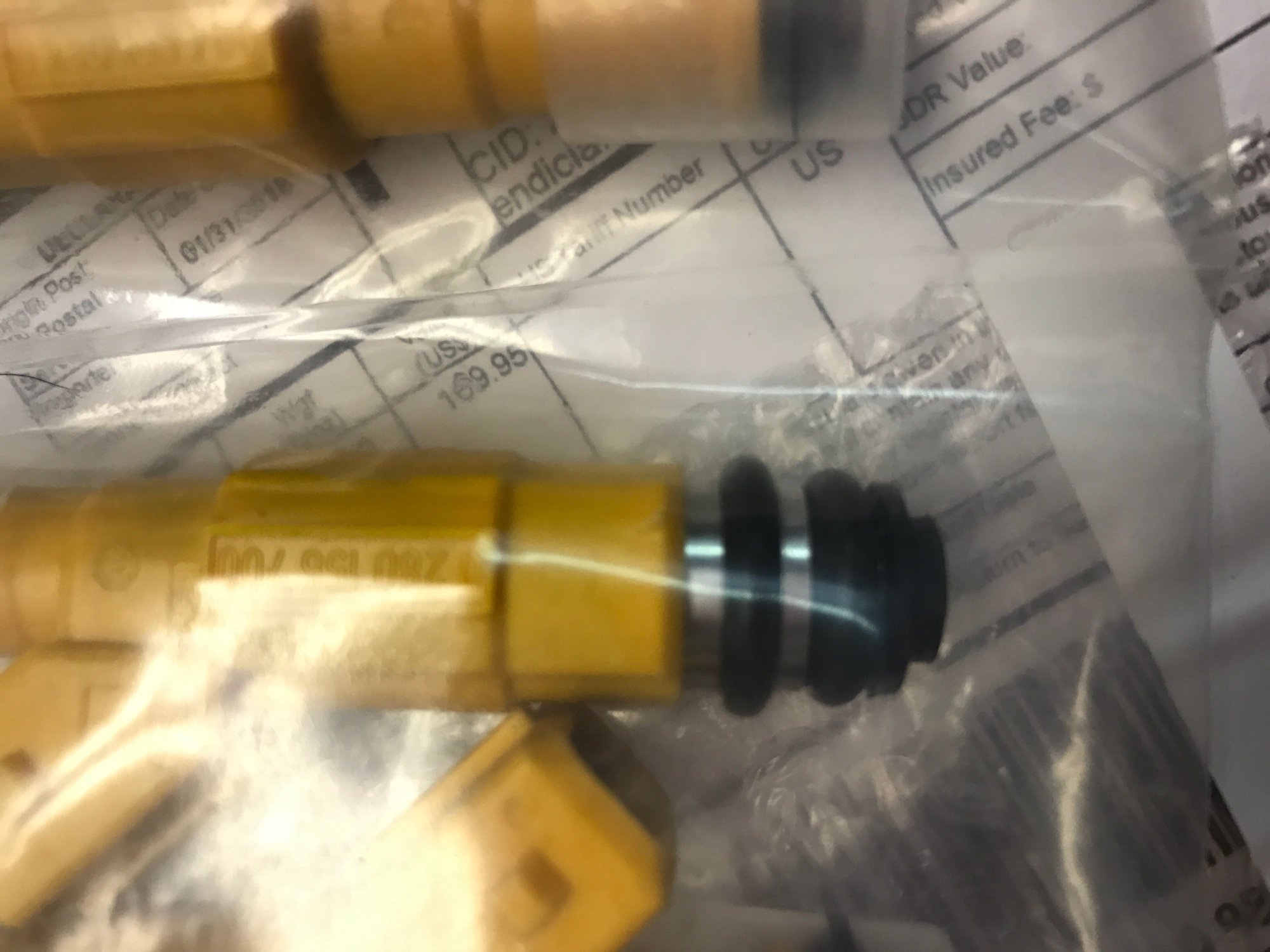

i just revieved my b3's from john. still in the pckaging. for an 86 ironhead (which i do not think matters # wise just saying)
instructions from john and image of injector with two orings.
note point 3.
note two orings.
