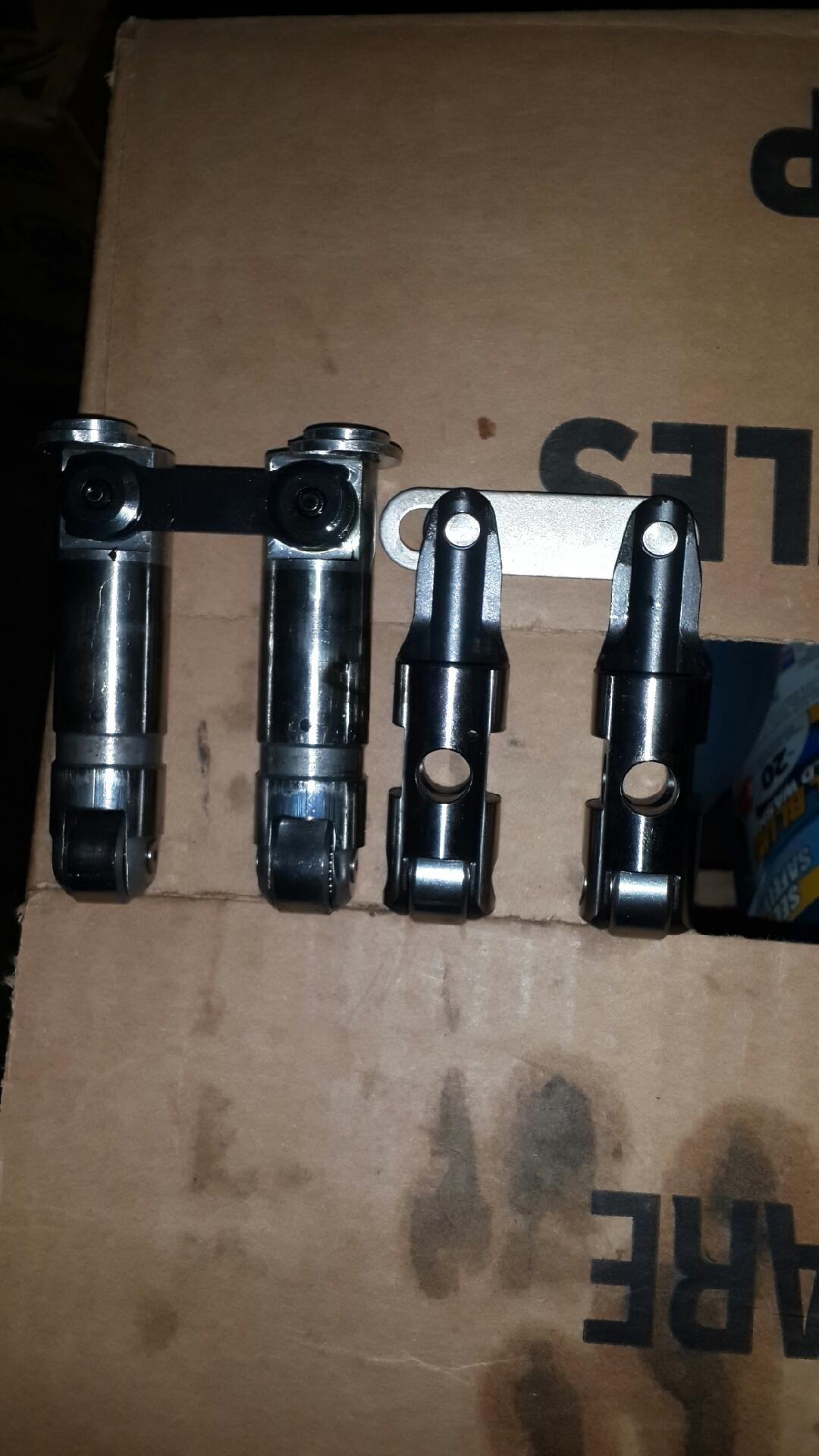

..... The lifters on the left (originals ?) have quite a bit of pushrod offset built into them and the roller wheels look a LOT bigger in diameter ... cannot tell if there is any offset on the ones to the right ... that could cause some geometry issues ... I'm told that the solid bushing lifters need more oil than the needle roller bearings ... you might need to remove the restrictors .....

The new one lifter have 180 offset. thsts wshat the Brodix -12 heads recommend. Back in 2002, I could only get 150 for the tsller lifter bore.

I will check about the bushed lifters oiling issue,thanks for the heads up
