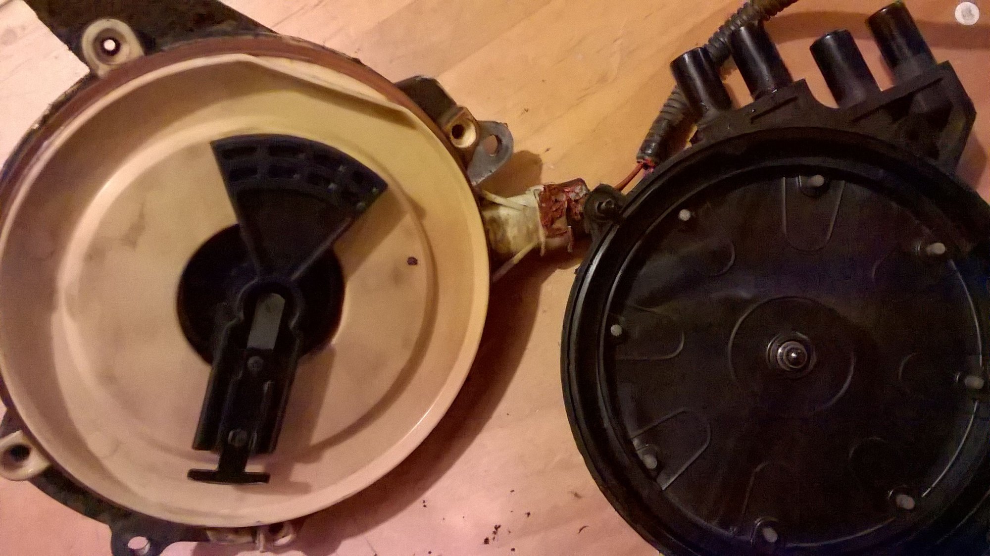

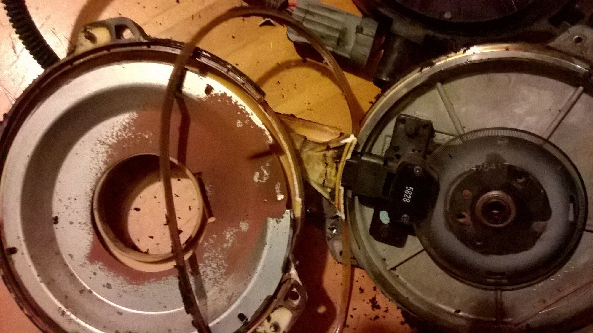

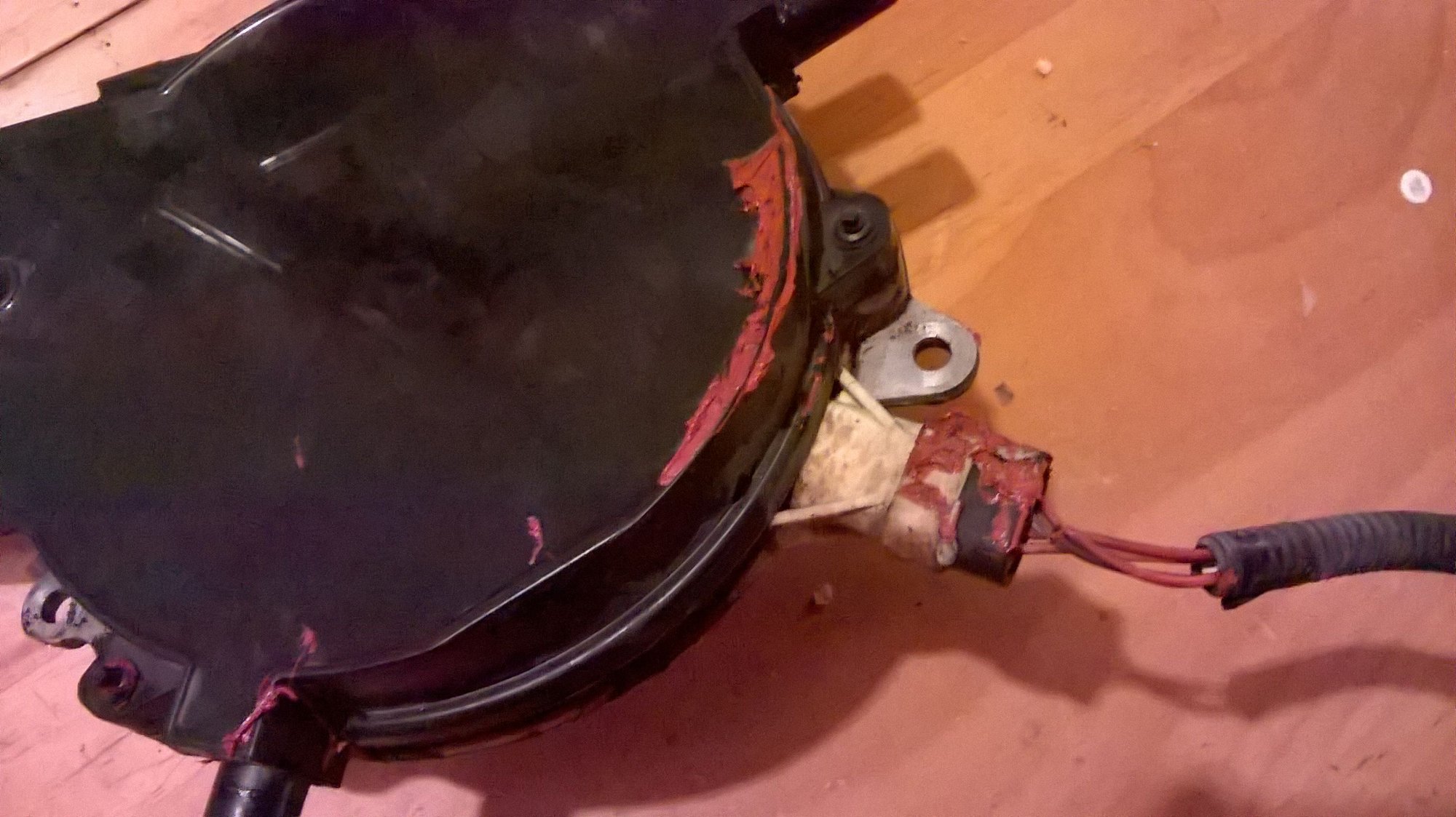

here's some pics, air inlet hose was cut like mtw's. maybe the same idiot worked on our cars. the connector had broken and been "silicon glued" together. that orange stuff in the optical sensor section isn't paint. surprisingly the rotor and cap looked pretty good. i have no idea if this is original or aftermarket. hopefully this is whats causing the mss.

just wanted to update this thread for users that may be in search of a solution to the same problem or problems. Finally got it all bck together. Looks like the optispark was the main problem, no more miss, no more obd2 code p0300, cleared and did not return. I should mention that this is/was "while you're there" job. Also replaced ICM, coil, crank sensor, opti seal, water pump seal, front crank seal. I found replacing the opti a tough job. Could not get it to line up properly. Did not want to pull the new cap and rotate the rotor so i pulled apart the old opti down to the hub. plugged that back in and rotated the shaft to where she would drop. Pulled it out while holding in place and marked the back of the housing. Transposed the mark onto the new housing and after a couple of tries got it to seat properly. I've done a ton of "normal" SBC & BBC distributor pulls and installs with no problem, this opti BS however was a big PIA. Hope that helps.
