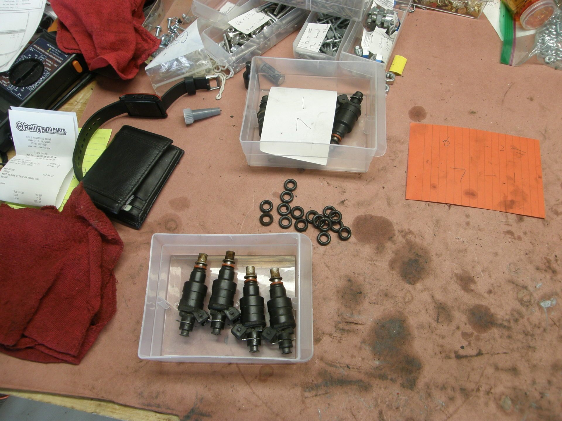

Here's my injectors while working on my '87:
Uh, no, I always clean my workbench.
I have no idea if my PO installed these or if original. They look similar to yours, 81c3. They are resemble the EV1 except for the pretty color and different end.
Note: where the orange washer is near the tips, that's where the orings go, hadn't gotten around to that in the pic.

Same ones in my car kael
