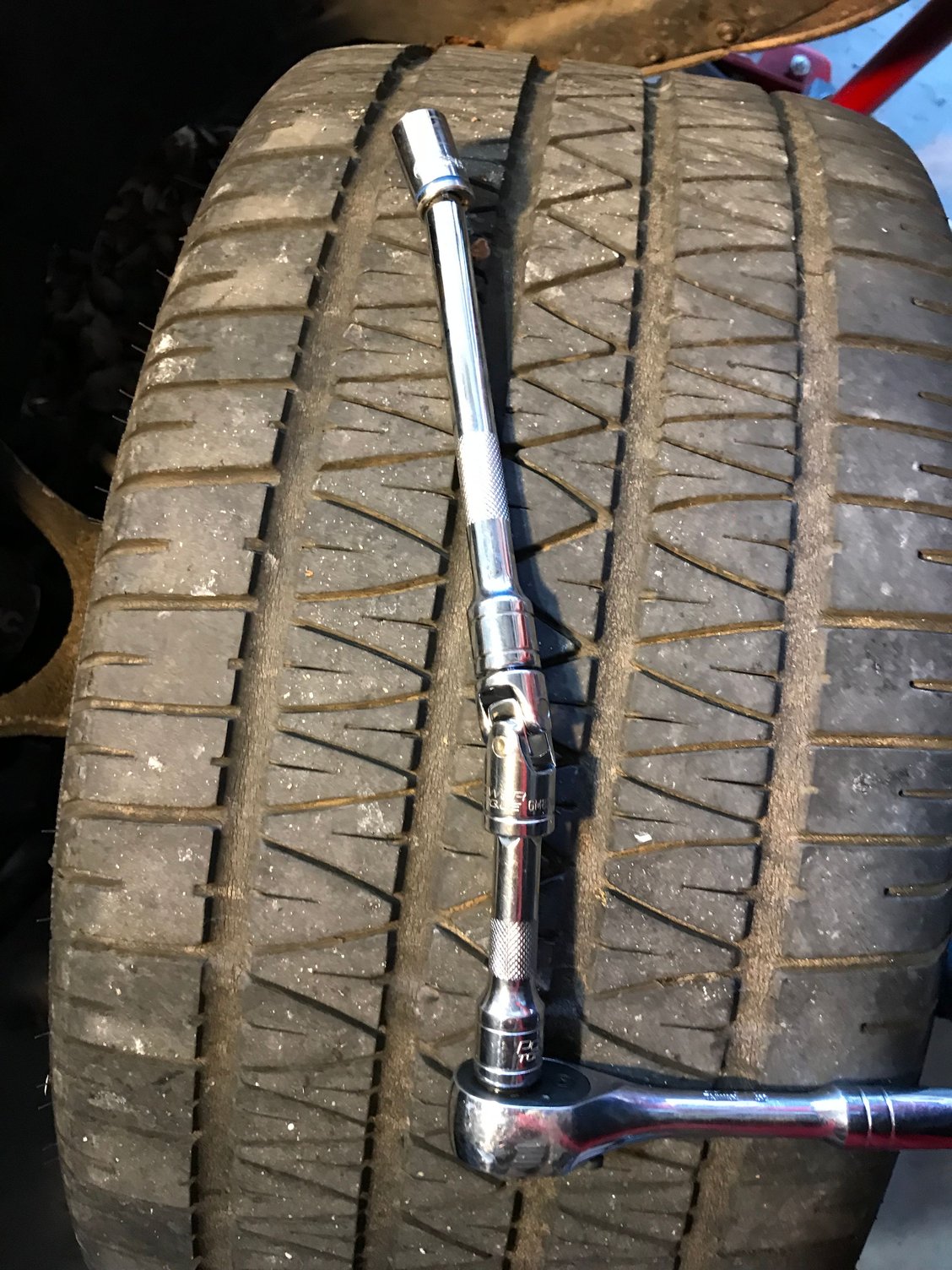

This is is the configuration that finally got the lower master cylinder bolt off, btw.
i did not prime the slave cylinder, and it was quite the job getting it all on there-I’d very much like to avoid doing that again. Have I screwed myself over? Do I have to take it all apart again?
