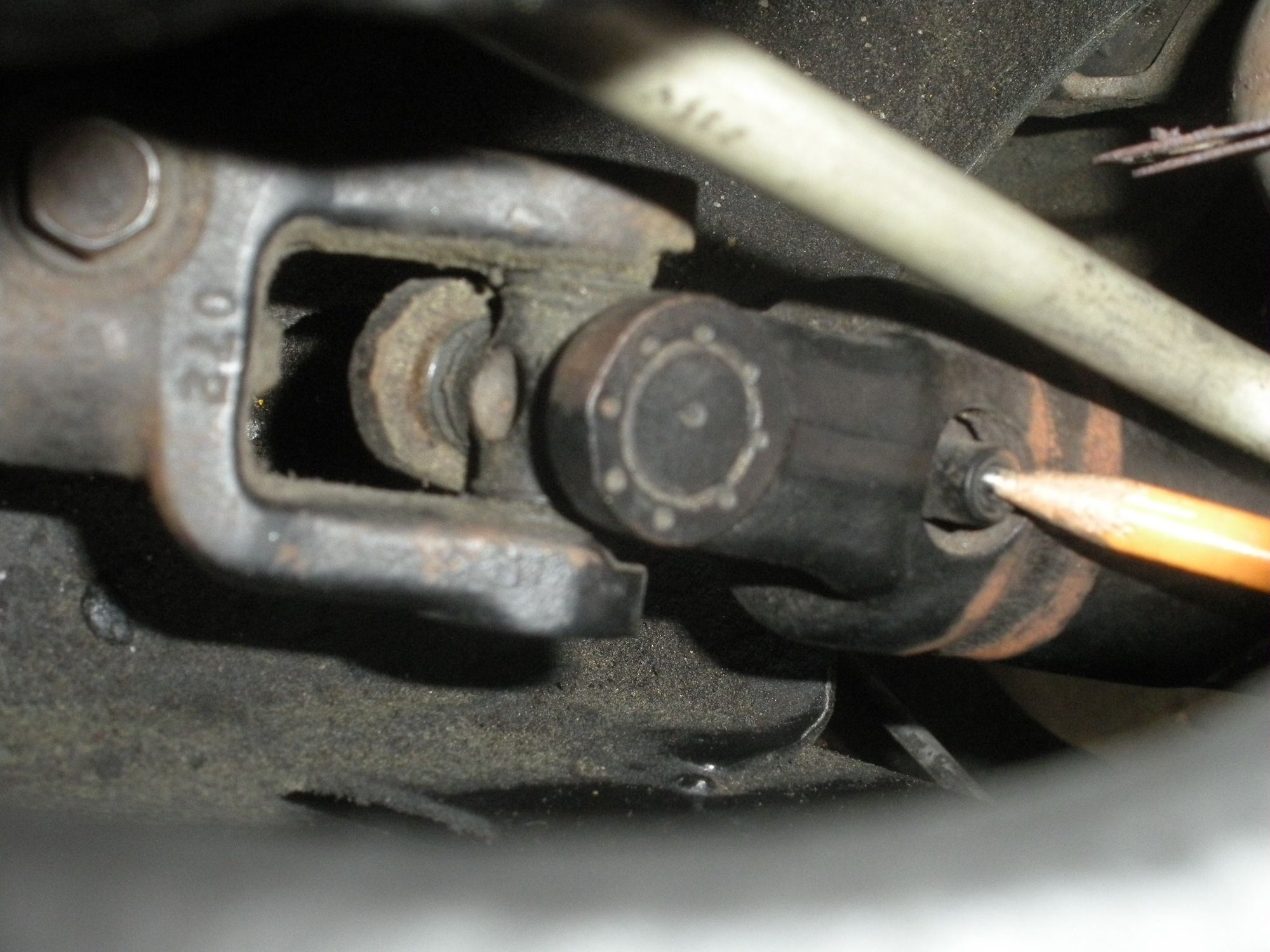

This is very easy to check. There are no "shields" in place to see this problem. It's directly below your alternator. This intermediate shaft design is '84-'85 only. The '86 is different.
It's also an easy repair. There is a shield at the top of the intermediate shaft, but it's easy to remove. The two bolts at the top and bottom of the shaft need to be completely removed, then the slip joint allows you to pull the shaft off of the splines, and it's out!
This pin should stay centered in the hole at all times:

That's exactly why there's a slip joint in that intermediate shaft! Look carefully at the rubber vibration isolator at that pin location shown in my photo to be sure the pin is centered in the hole. It would all depend upon how much damage the car sustained.
If there's any possibility it's good, I'd try using it. If it doesn't work out, you will have learned how easy it is to do the job again! It's not un-safe to have this problem, as you have already learned.

Yep, it looks like I'm missing that bottom shield. It makes sense there should be a shield at that spot. My car isn't an NCRS primo. At thirty four years old, and 240,000 miles, and who knows how many previous owners, that's no surprise!
Originally Posted by WVZR-1
The collapsible section that creates the slop I thought was above the yoke/spline.
The collapsible section is in the center of the shaft, and is separate from the vibration isolation section. It's the vibration isolation section that has the rubber insert that fails, causing the off-center problem.
The collapsible section is like a "double D" configuration.
