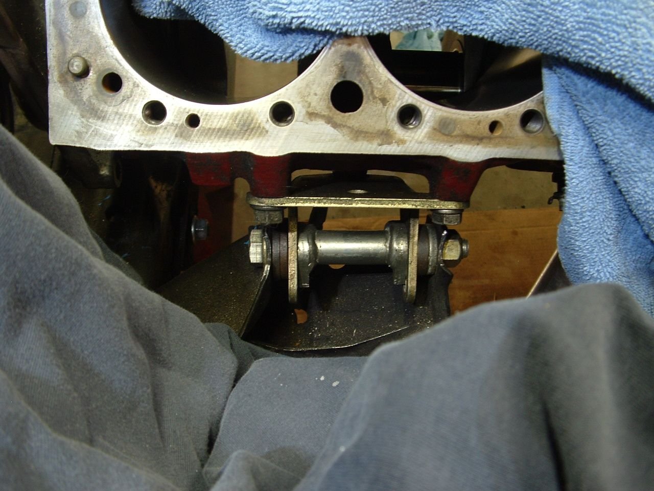

..... Moroso ... I had these on the shelf so I don't know what part # but this was a frame/engine set that I cut , drilled and spaced with large flat washers ... I did the drivers side only , I have urethane on the passenger side ... I'd sell the other side for $50 shipped .....
