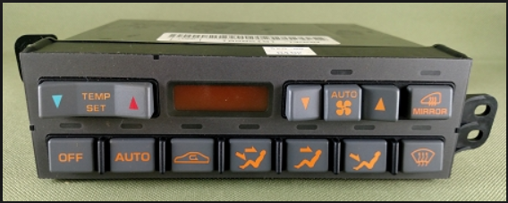

Does it have the C68 climate control?

Define C68.

C68 is the automatic temperature control.

And, yes. My car does have the C68 control.
