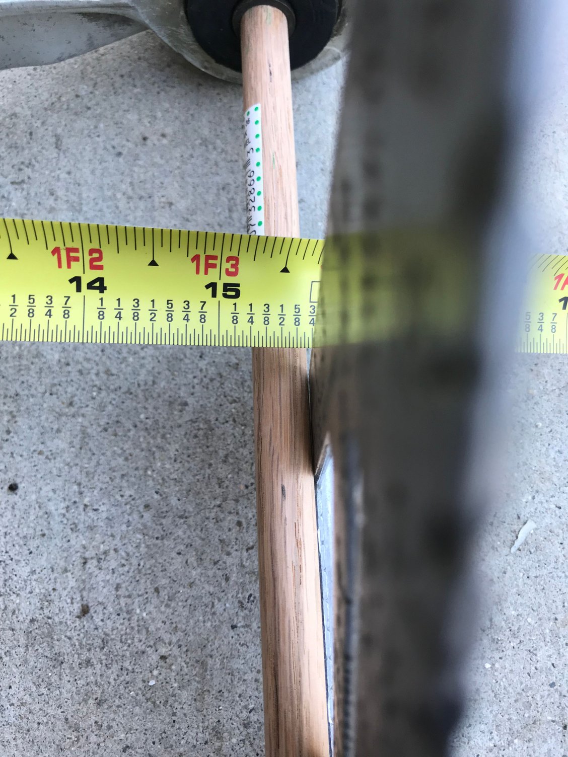

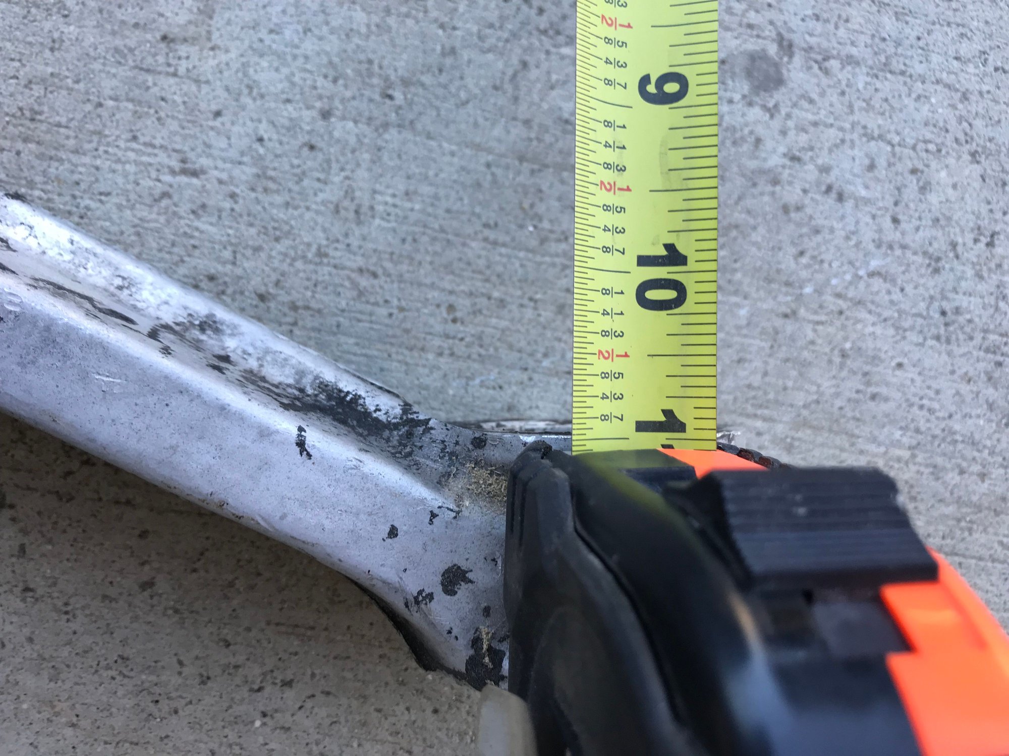

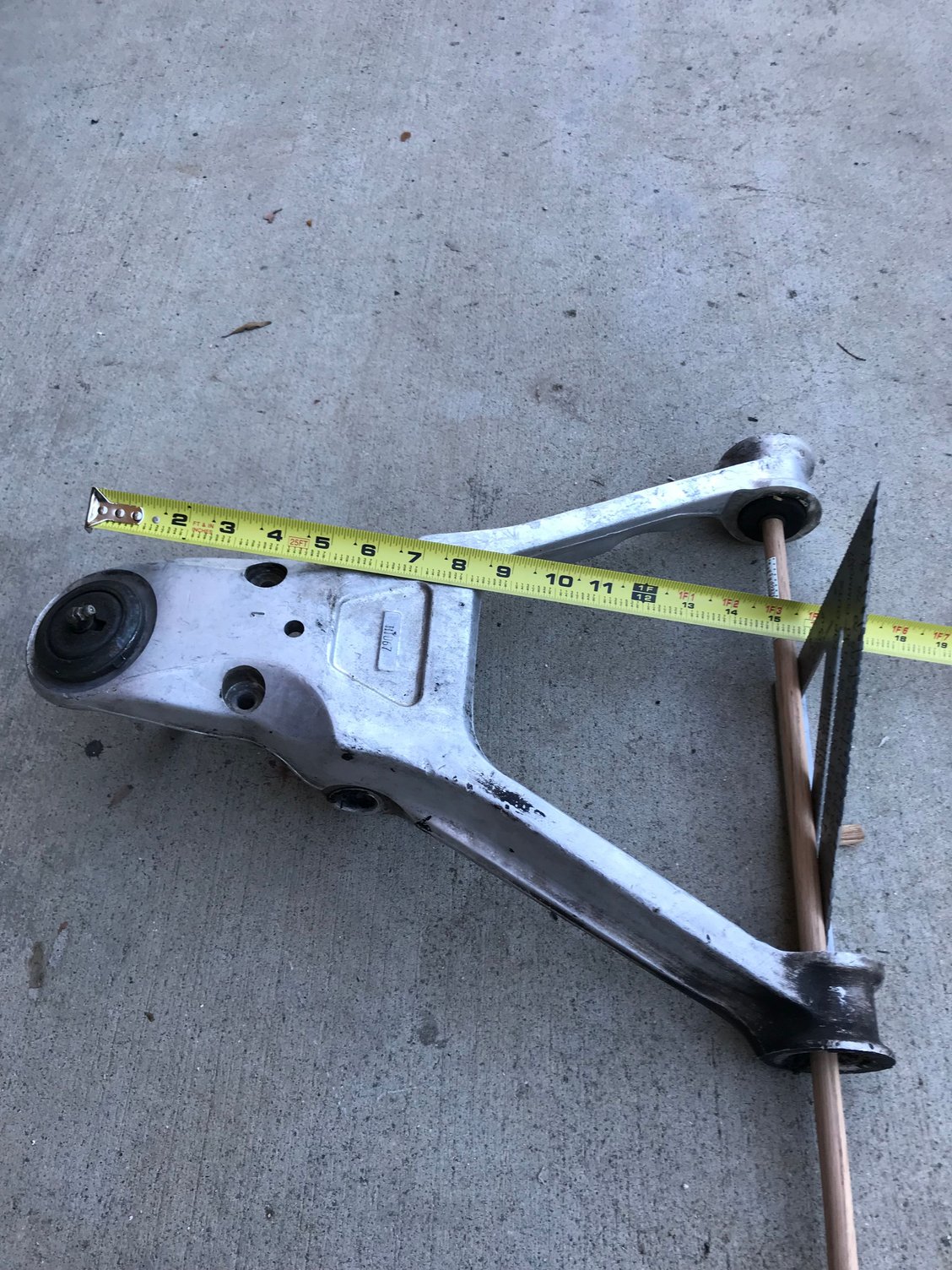

If you can also measure the length from a line through the pivot axis to the center of the ball joint it would be a lot more accurate than what I can get on the car.
Old Feb 25, 2018 | 05:34 PM
bill mcdonald's Avatar
bill mcdonald
Joined: Oct 1999
Posts: 6,366
Likes: 34
Not easy at all to do with it off the car. This is not very accurate, missing one bushing on each arm. Gave it a shot
Doing various things, it looks more like 15 1/4 to 15 3/8
With the ball joint side up, it can be whatever since that moves around free.
